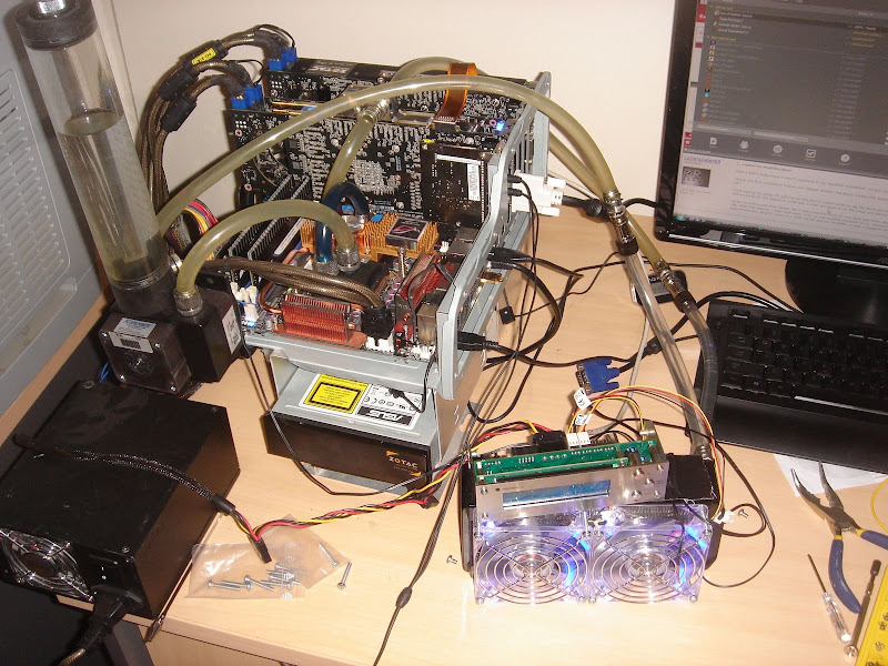

    I set up my aquaero today and thought id use it to test out a little radiator ive had sitting there not doing anything much because i thought it was too small.
    The HW Labs M184 GTX, a dual 91mm radiator. With a frontal area of just 165cm² its a bit smaller than a 140 (196cm²) but bigger than a 120 (144cm²).
    Ive hooked up the aquaero as follows
    Sensor 1 - Air in
    Sensor 2 - Air Out
    Sensor 3 - Coolant
    Fan 1 and 2 are on the rad, with speeds controled by sensor 3 (coolant) min 25°C max 30°C
    The Loop
    The loop consists of EK Dual DDC>Dtec Fusion on a QX9650>S2E Fusion NB/SB > EK FC 295 > GTX184 > EK Multioption
    ewwww
    dont wory about the rough setup... this is just a test bed.
    Fan Specs
    The fans im using are *cough*thermaltake*cough* 91mm fans... I know I know... friends dont let friends bla bla bla, but the specs on these looked pretty good for what I wanted... and the shop only had these or "gentle typhoons"
    Fan Dimension - 90 x 90 x 25 mm
    Fan Speed - 1300 RPM @ 20C ~ 4000 RPM @ 55C
    Bearing Type - 1 Ball 1 Sleeve
    Noise Level - 17.0 dBA @ 1300 RPM 48.5 dBA @ 4800 RPM
    Max. Air Flow - 24.6 ~ 78.7 CFM
    Max. Air Pressure - 1.30 ~ 7.20 mm-H2O
    Power Connector - 3-pin
    Rated Voltage - 12V
    Started Voltage - 6V
    Rated Current - 0.15 ~ 0.48A
    Idle temps...
    well CPU crunching at 100% is idle for me since its going 24/7
    Fans running at 5.9V, nice and quiet
    Coolant is at 27.5°C with Air in at 20.8°C (6.7°C delta)
    CPU was at 37°C
    GPU at 31/38°C (damn my uneven 295s)
    Ahh crap... I just realised the screencapture utility didnt get my everest osd
    Full Load
    As you can see the little bastard is barely breaking a sweat, Fans up to 77% (~10V), Air in 19.6°C, Coolant at 29.1°C (9.5°C Delta), GPU temps leveled off at 46°C.
    overclocked and loaded
    fans went to 12V trying to keep the coolant under 30°C.
    All in all im very impressed by HW Labs little rads.
    Testing the Micro 80 next

    Thanks for testing. ~4000 rpm? o_O
    Banned
    Apr 2008
    Perth, Western Australia.... mate
    738
    Quote Originally Posted by alacheesu View Post
    yeah, but LinPack and Furmark are waaaay over the kinda load any real world app will place on your system.
    With just boinc running it sits at 6V ~2000 RPM & ~20 dBA
    With GTX rads its all about having fans with a good range and a good fan controler.

    ballzor any chance you can connect an inline 300W heater and see how it does?
    I think the majority of the testers use a 300W heater to get a delta.
    Would love to see an exact load to see how it scales.
    Quote Originally Posted by DarthBeavis View Post
    so you think multiple of the midget radiators would be better in series? I will probably use a single vario D5
    I think you'd be better off with the single fesser 480. Less flow reduction, more passes in the same time, as well as a larger cooling area.

    Quote Originally Posted by Waterlogged View Post
    Is the flow pattern set up the same as their bigger brothers or is it like traditional rads?
    Im guessing its the same... is there a way to tell without cutting it open?
    Are you meaning Rad>Block>rad>block>rad...
    remembering that fluid temps are pretty much even throughout the loop I think that a single rad would be preferable to multiple simply due to the reduced head loss.
    One thing that would be cool is these rads are so small, you could tuck a few of them away into spare spots inside the case and add up to having the equivalent of a 480 without having a case that fits a 480 (not sure i explained that too well).
