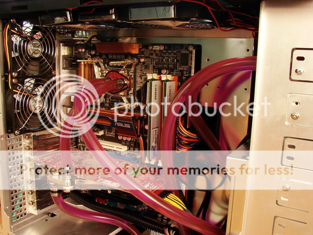

Drilled 3 holes in the mobo tray, 2 for the 24 pin mobo connector (dremmeled to make it square after trying to line it with 2 1” round grommets which looked rubbish) and 1 for the 8 pin mobo connector which is in the top left.
(Charles from www.muderMod.com pointed me back at Home Depot on my quest for some big rubber grommets and generally gave me some good advice and is a genuine star!)
I picked it all up from NCIX Vancouver at the beginning of September, and set about putting it together about 5 days later it had gone through some serious leak testing (well it had sat there running the pump while I looked at it wondering how I was going to get it to all fit together in a way I was happy with!).

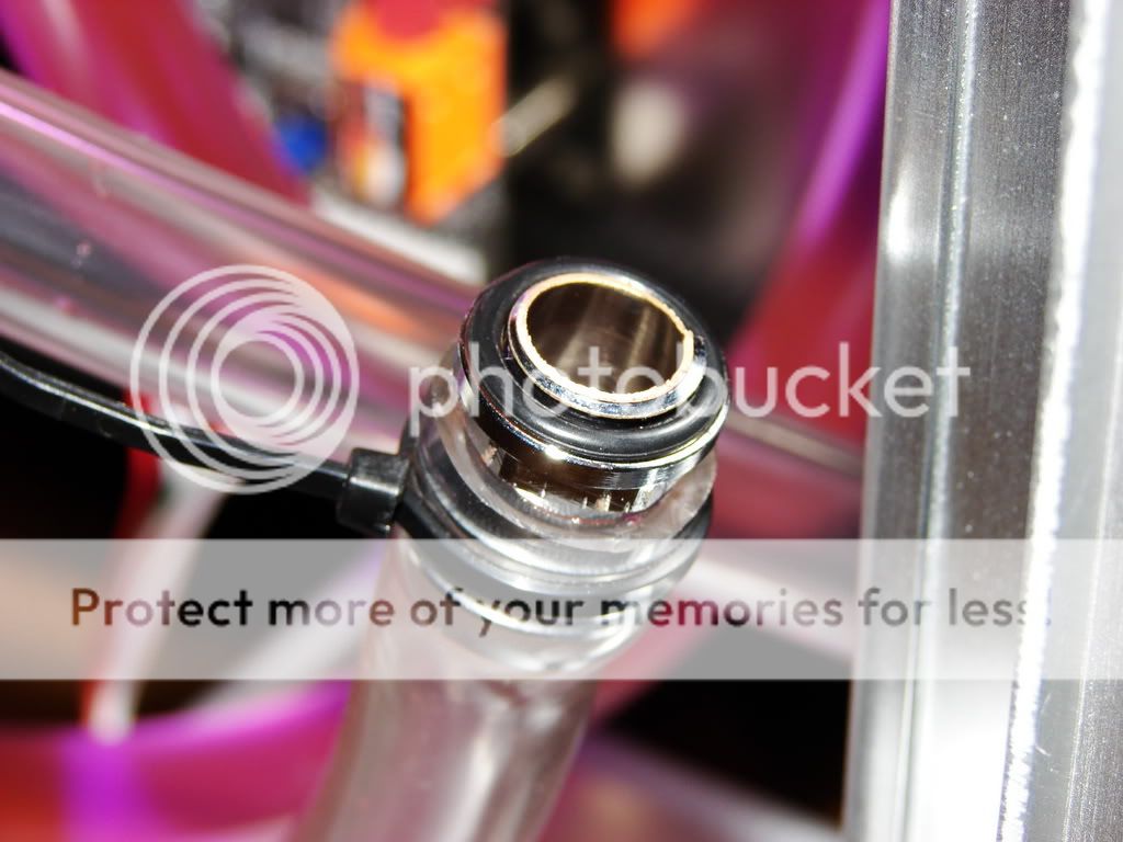

So it was ready and I started putting the rest of the components back in. All went well until I screwed in the grounding cable from the PSU onto the drive bay housing towards the front of the case). While screwing it in I noticed a small puddle under the radiator!!! The barb had sheared completely!
So I drained it all and went to bed in a bit of a mood
I contacted NCIX and they contacted BP, replacement barbs were offered but after looking at the broken barb I decided I’d like something a bit more substantial with a fair bit more thread

Danger Den G1/4 to 1/2IN Perfect Seal Barb Chrome Fittings (2 Pack) (I like the extra long threads these have compared to the BP fittings)

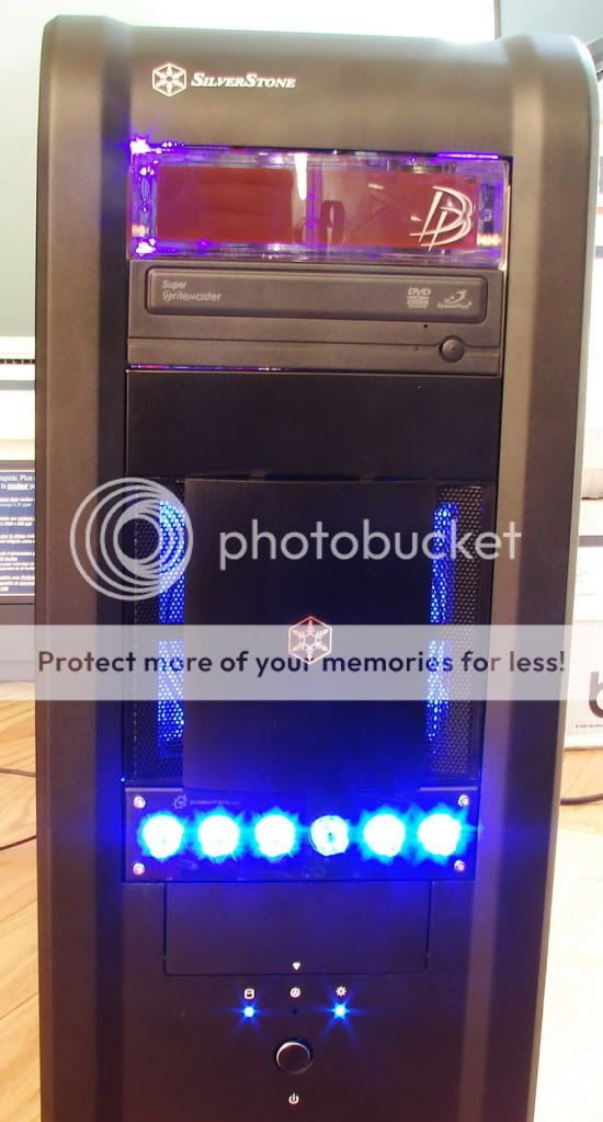

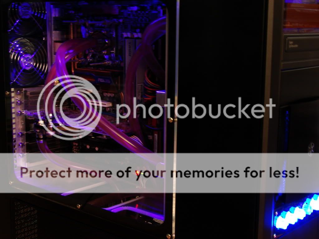

And there you have it, full purplified, well probably.
Currently running at 4Ghz, 50 degrees, almost silently (difference between fans/pump on full and silent is 2 degrees…) The 4870 is clocked at 790/1100 and doesn’t go above 35 degrees
Mmm, those hanging down wires at the top have been removed from view.
Bathe in the magnificent purple.
