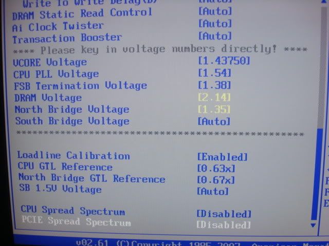

    yo here, are some screenies of my bios, Could I get some suggestions on what I should change/use and stuff..... I kind of guess and checked these settings up to this point, they are OCCT 7 HOURS stable, but sometimes it won't POST the first time, lol! I have a feeling it's my RAM...
    Anyways, my goal is to have mostly my OWN settings, without AUTO... because I already reached 3.9ghz stable with mostly auto settings and I want to fine tune my system with my own settings to get some better performance and perhaps more stability. Suggestions please!
    p.s. my vid is 1.225. And is this jsut for results or can suggestions be given also? I'll remove it if so.

    You have the same VID as mine. This is mine @3.6Ghz stable and I use it 24/7 so you might wanna take a look at it to compare:

    Well with my settings I got about 8 hours stable on occt, or however long I slept last night... And that voltage was just a guess voltage, cause I'm going higher then 3.6 for sure.

    By the way if anyone likes to see what settings i used for my setup. I just updated my signature to reflect my template i used for Bios 1103 and now same for 1201.
