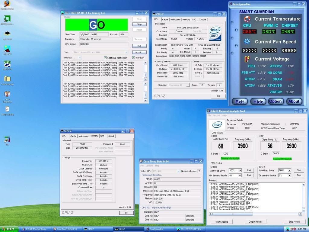

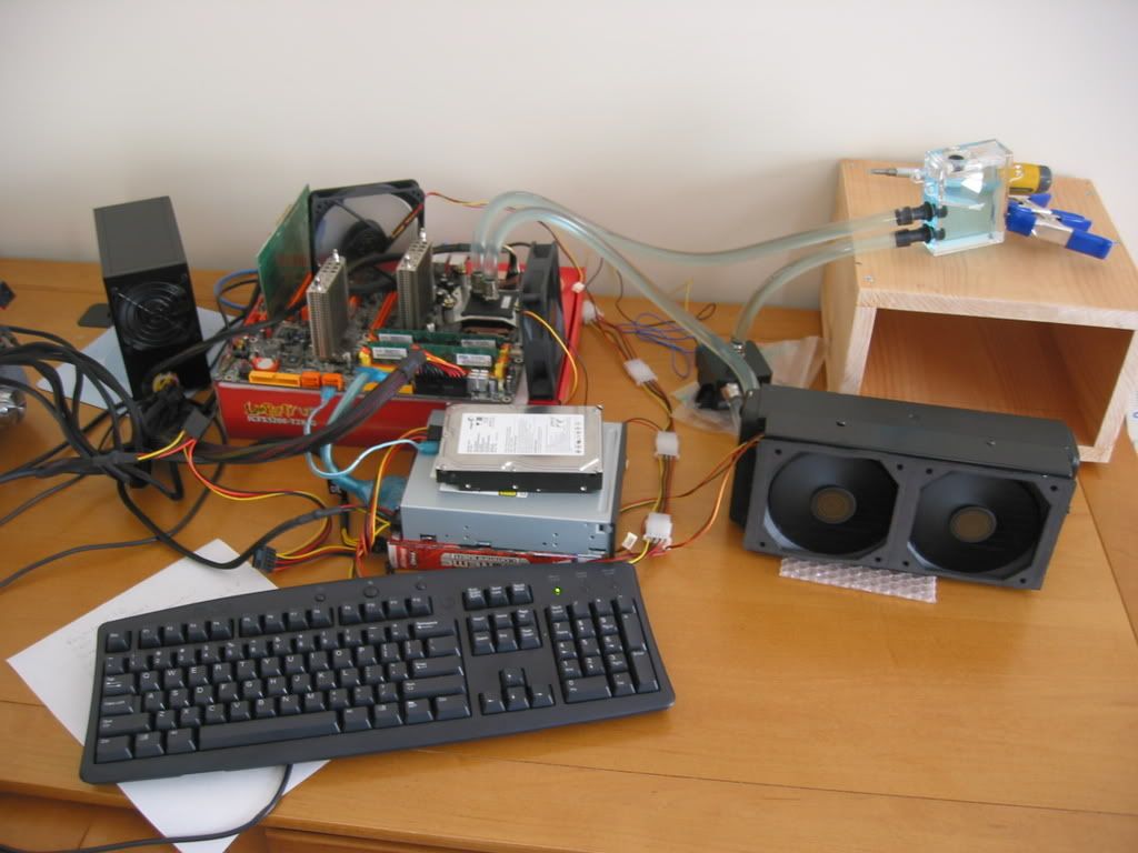

    Just messing with a bit of watercooling now.
    These settings are working quite stable for me. More testing will continue.

    BlueAqua it looks like u put the fans inside the Shroud?

    Quote Originally Posted by Ten
    I did actually, just temporary as I didn't have any screws long enough to attach them correctly. Still works though.

    Xtreme Member Ten's Avatar
    Apr 2005
    Lappland/Sweden
    142
    Thanks
    0
    Thanked 0 Times in 0 Posts
    yaeh it wrks but i looks strange but it's just temporary so

    Quote Originally Posted by BlueAqua
    Flip the fans so they Suck thro' the Rad, as opposed to blowing. This will help reduce the Dead Zone immediately behind the centre of the fan.

    currently @ 3.5GHz (390*9) at 1.4V set in BIOS, everything else at stock, dual orthos 14+hrs stable (and that's dual for stressing all the memory) and I'm very happy with it.
    But anything over 400MHz FSB is getting unstable, with all voltages raised, I'll have to explore this... I'll be tweaking mem. later, here a screenshot of the benching:

    Quote Originally Posted by marauder16
    Be very careful with Syncing memory on this board
    I really think this is a bad thing and stress the chipset way too much...until a bios is released priven to work in sync mode...beware
    very nice..
    bro Ive seen your rig on the water cooling case post..
    what blocks are you using?? have you water colled the chipset??
    I'm planning to water cool my setup..
    thanks

    @erwinz:thnx man, my w.c. setup is in my sig, I'm planning on putting a HR-05 on the chipset, but I'm not going to watercool it.
    btw. got 3.6GHz stable, going to bench 3.7GHz, I'm not stopping before I get into the 4GHz club
