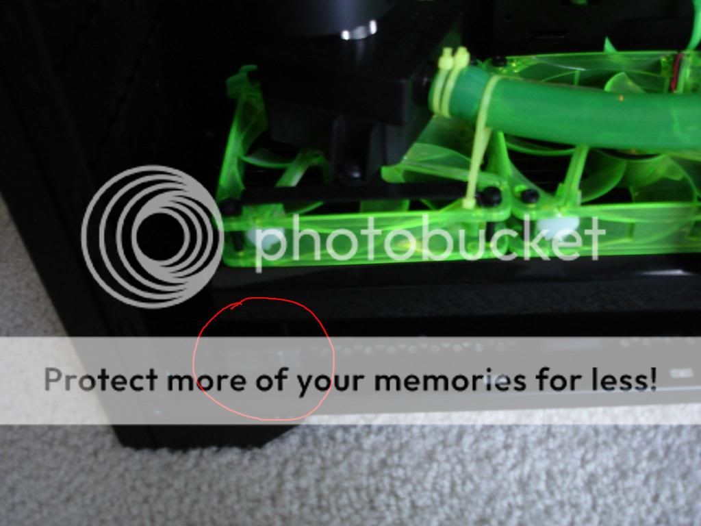

Here's pics of my setup, I wish I had taken more pics during the build.
Only one side of the bay cage needs to be removed, as it is connected to the bottom cage as well, case is still stable as a rock though.
I think I have a pic somewhere of it de-riveted (entire case) as I replaced the rivets with all black ones, I could probably illustrate where to drill the holes in the bottom panel then. I'll see if the pic's somewhere on the HDD.
The radiator bracket is marked in red in the one pic.
http://i810.photobucket.com/albums/z...e/DSC03799.jpg
http://i810.photobucket.com/albums/z...e/DSC03800.jpg
http://i810.photobucket.com/albums/z...e/DSC03798.jpg

Hey school, that looks like you have taken the filters out, right?
Thanks for clearing that up.so would it be possible to use the filters as we'll? Also which rad is that?
Yep, it would be possible to use filters.
Also, as someone else said, you could use a weak magnetic clip on filter on the bottom of the case.
I'm using a HW Labs GTX480 radiator
Thanks man...and my last question...does it require cutting the drive bays or just removing the rivets?
