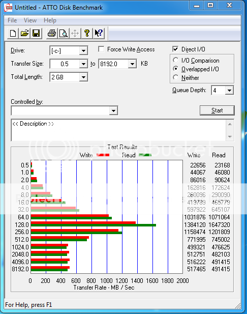

first on the 9211, if someone could give me some simple instructions on upgrading the firmware I'd appreciate it..
http://i787.photobucket.com/albums/y...OKE/atto-1.png

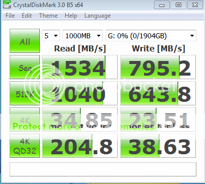

Could you do a few benchmarks that includes random iops.
(ATTO is rather useless imho)
e.g
AS SSD, CrystalDiskMark 3.0 and some iometer benchmarks.

I will be doing lots atto was the first/easiest thing to grab, anyone have a good iometer pattern?

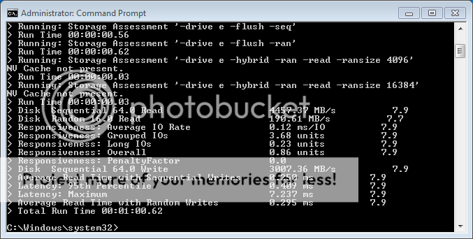

Could you do the winsat test?
It's a quick test
run "cmd" using elevated priveliges and then type
winsat disk -drive N
(subsitute N with the drive letter of your array)

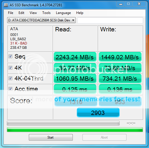

The AS SSD and CDM tests are a bit low but I expect some tuning and upgrading the firmware should bring those numbers up a bit.
The winsat disk test is great, very nice scores all over the line :up:
I guess you'd easily get much better scores using the LSI 9260.
For testing purposes I'd use one of the drives for the OS and the others for testing. (but thats me :))
I think there is something wrong with the AS SSD and CDM results.

It does, I've gotten over 2GB/sec read/write on wei, and it seems great randoms though latency is kind of high but I knew that from reviews.
The scores generelly aren't that bad, well, the sequential scores are down a lot from what I would have expected. (AS SSD and CDM)
If you haven't upgraded the firmware I'd do that as soon as possible.

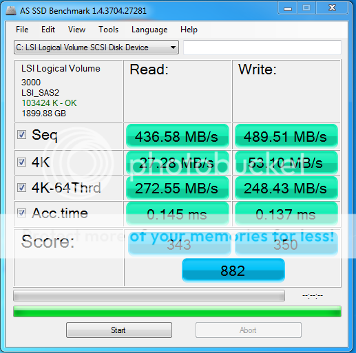

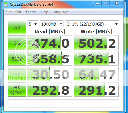

ewww, those numbers don't look right at all.
If you are still playing around with the 9211 - you might want to try a soft raid (don't enable raid 0 in the LSI bios).
I also like the idea of starting with 1 drive and working your way up. :up:
The results are just fine for a 9211. The card starts throwing lower numbers once you get past 128kish. Dynamic raid should be much faster.

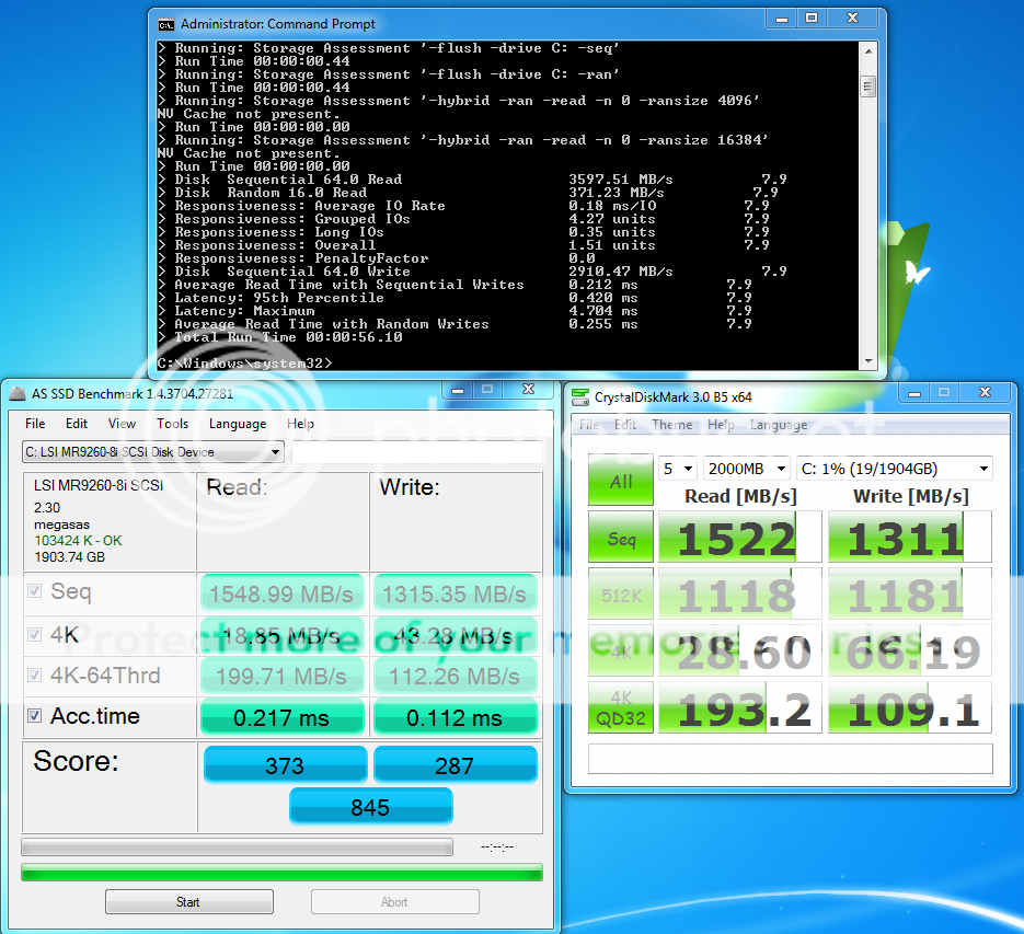

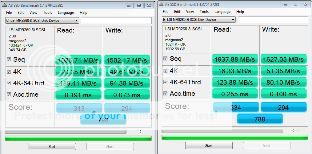

9260 asssd compared from above..
http://i787.photobucket.com/albums/y...WPOKE/9260.png
@ mbreslin
what settings r u using???
128k stripe read ahead
Did you update the firmware on the 9260?
No Read Ahead, Write Back, Direct IO works best for me. (using Intel's)
Stripe size 32KB-128KB depending on usage.
256k best stripe size No read ahead, Always write back (if u havent the BBU) and Direct IO
