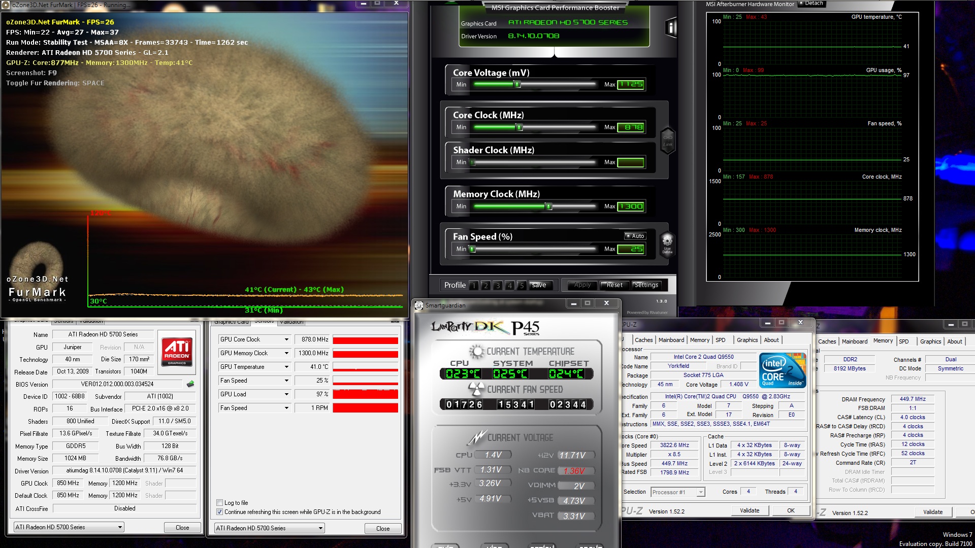

here is my load/idle/clocks
http://img260.imageshack.us/img260/8595/bestclocks.jpg

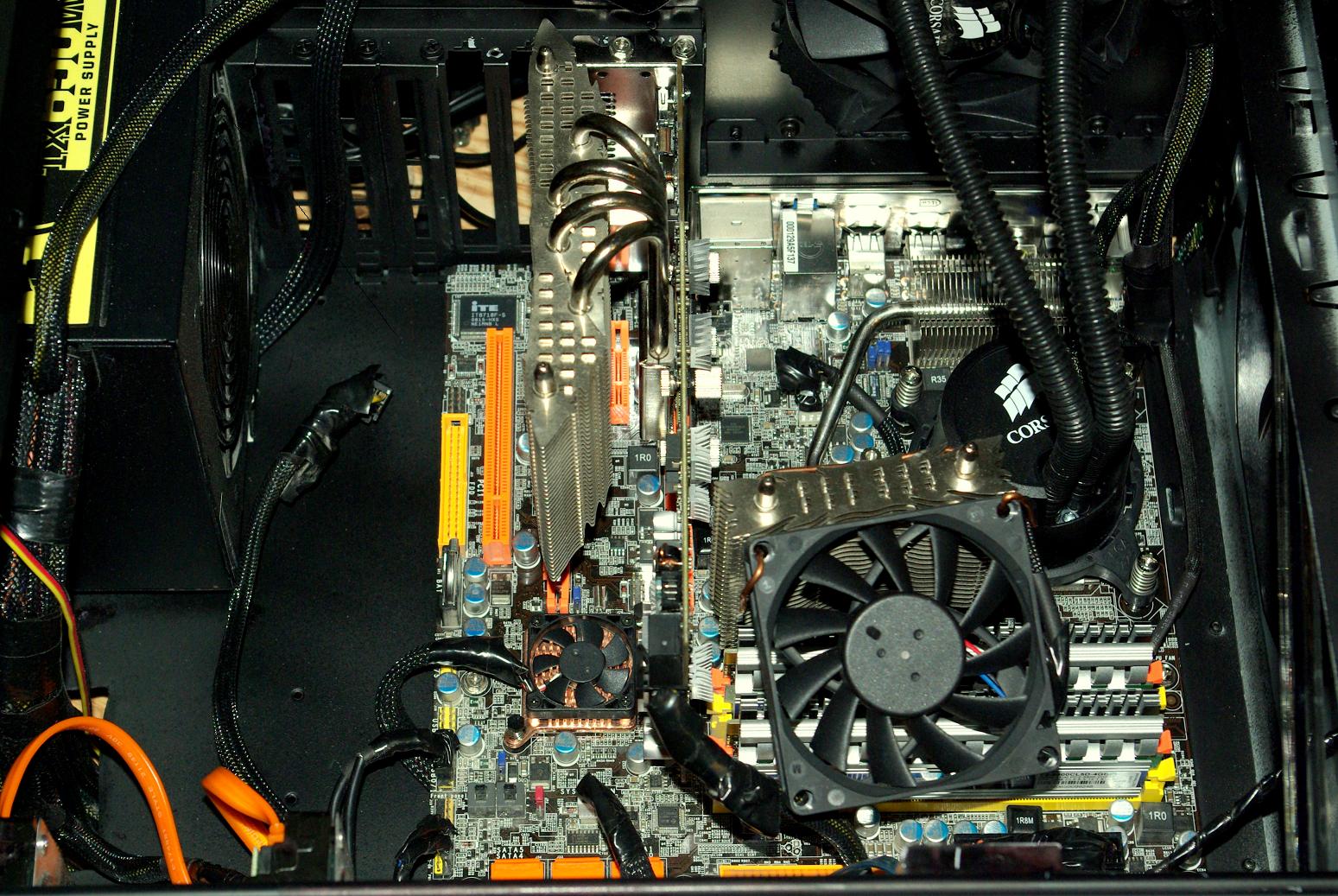

Ive posted mine a few times, but here it is again :)
http://img36.imageshack.us/img36/1636/dsc00425zw.jpg
