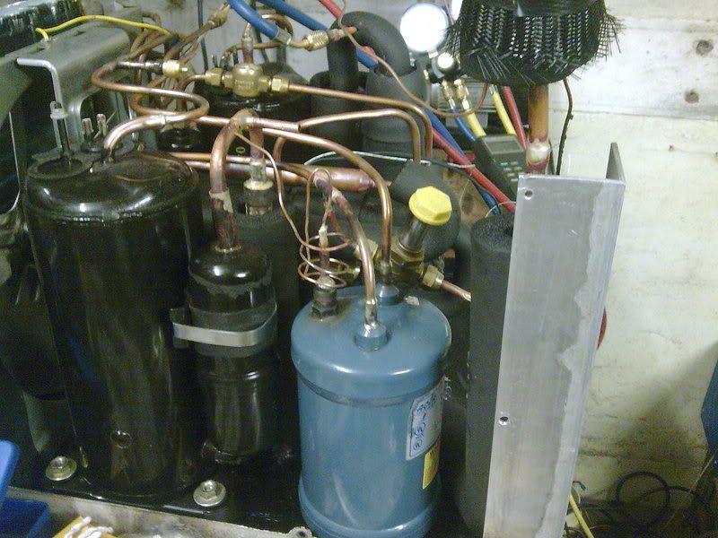

1st stage
compressor: panasoinc (4ps164e) 16.4cc
Condenser: large moddified from ac unit
Danfoss tev: Tes2 00 orifice
Hx: 24 plate
danfoss in line filter and sight glass
temp range -40 to -50c
R507
2nd stage
compressor: toshiba (pg135x1cy) 13.5cc
Oil separator: AC&R s5580
high pressure cut off switch 350psi-off 250psi-on
captube 0.8mm 0.031" xxx"
High pressure gauge

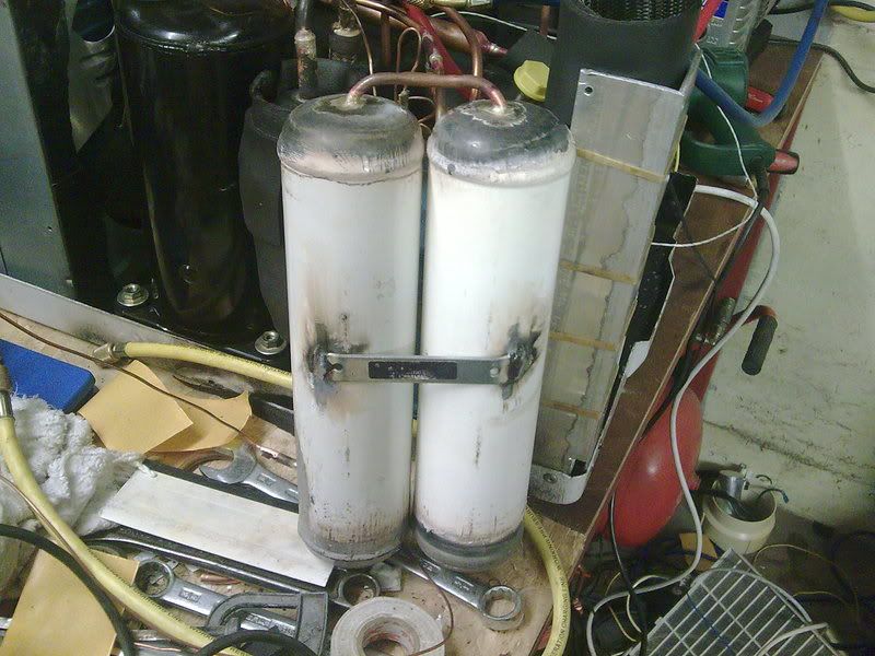

2l expansion tank
spun drier/filter
duniek evap

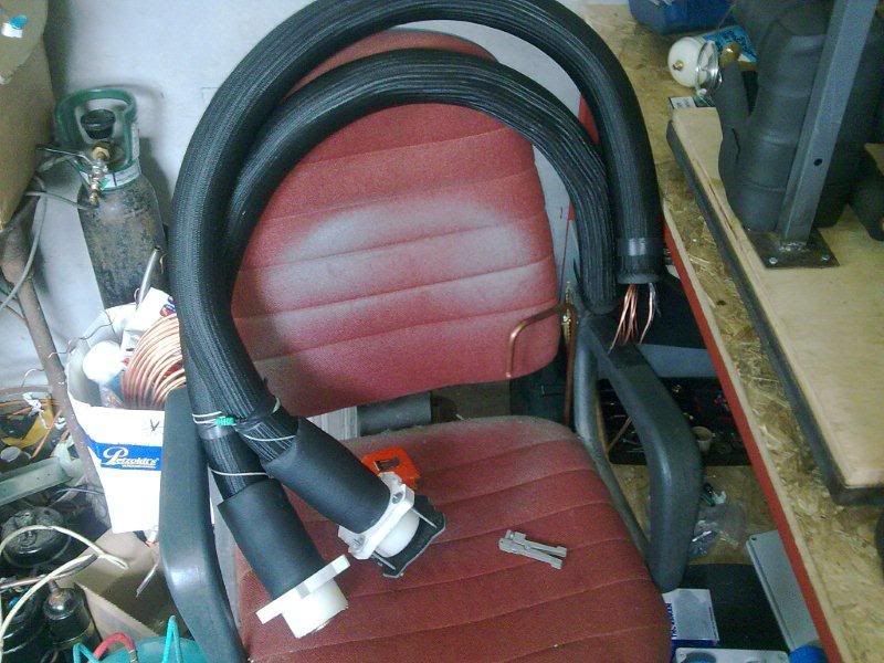

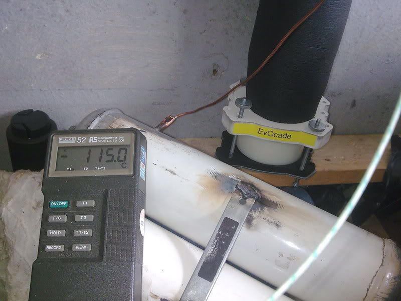

4ft stanless braded suction line

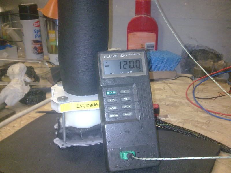

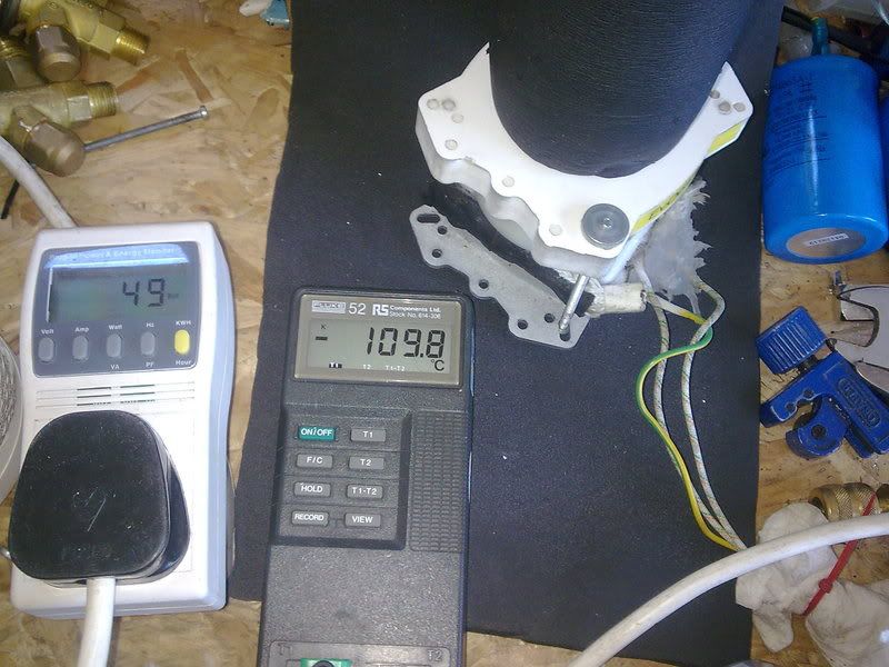

temp range -90 to -105c
R1150

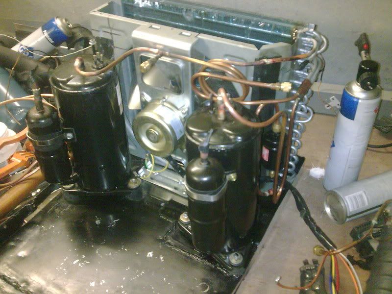

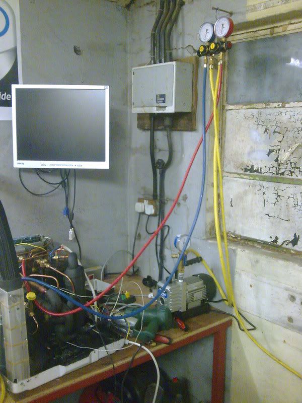

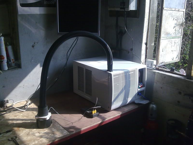

base and 1st + 2nd in place
http://i90.photobucket.com/albums/k2...e/Image265.jpg

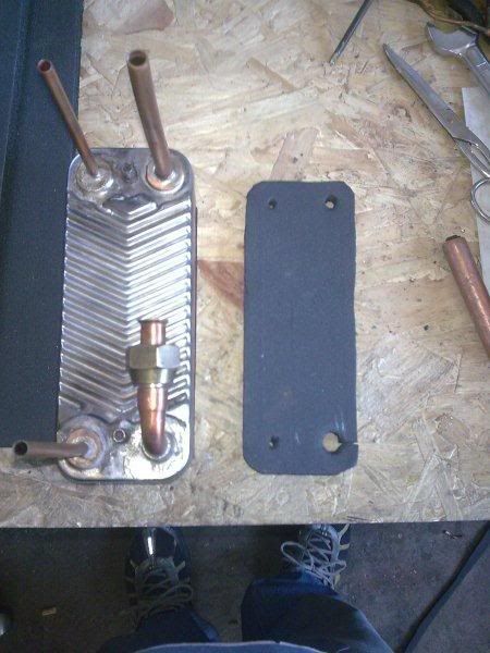

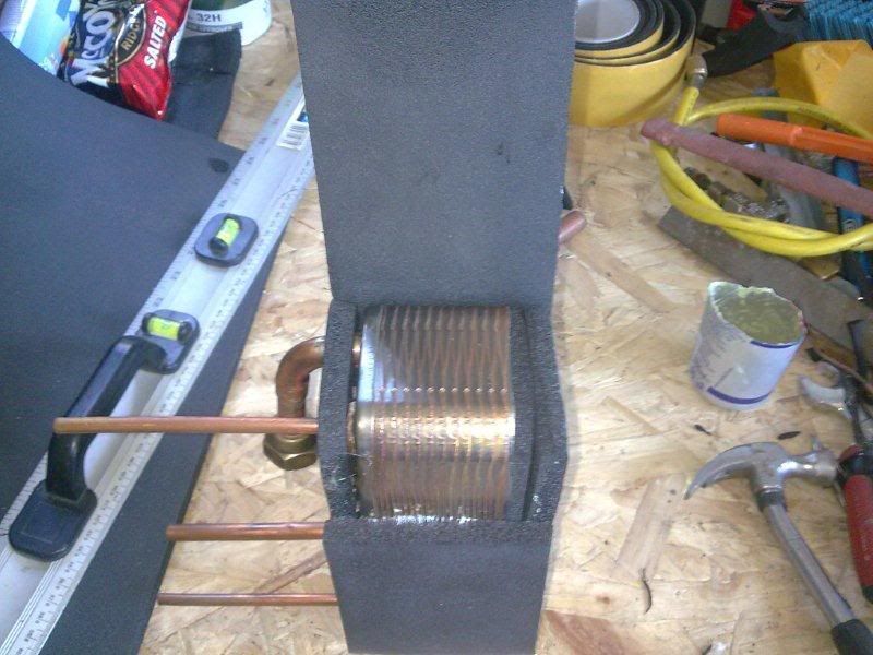

24plate hx
http://i90.photobucket.com/albums/k2...e/Image291.jpg
http://i90.photobucket.com/albums/k2...e/Image292.jpg
http://i90.photobucket.com/albums/k2...e/Image293.jpg
http://i90.photobucket.com/albums/k2...e/Image294.jpg
http://i90.photobucket.com/albums/k2...e/Image295.jpg
http://i90.photobucket.com/albums/k2...e/Image296.jpg
the hx was clean'd and washed out with water then baked in the oven @200c for 40mins mmm tasty

twins

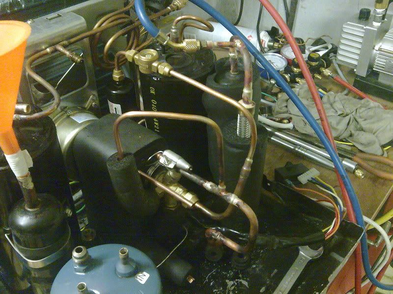

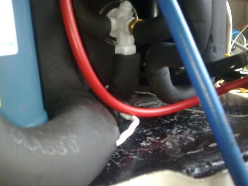

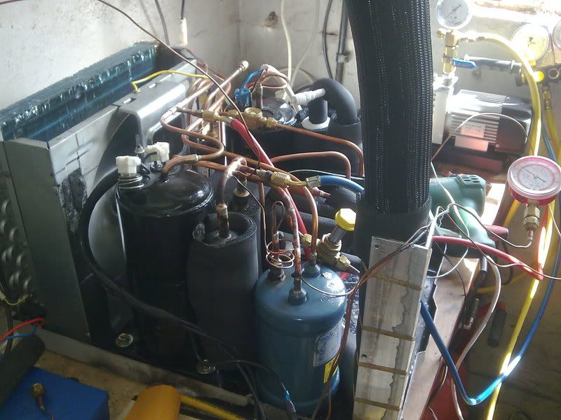

1st stage built and under vac right now:)
silly stupid extrnal txv with the extra pipe is a pita
http://i90.photobucket.com/albums/k2...e/Image300.jpg

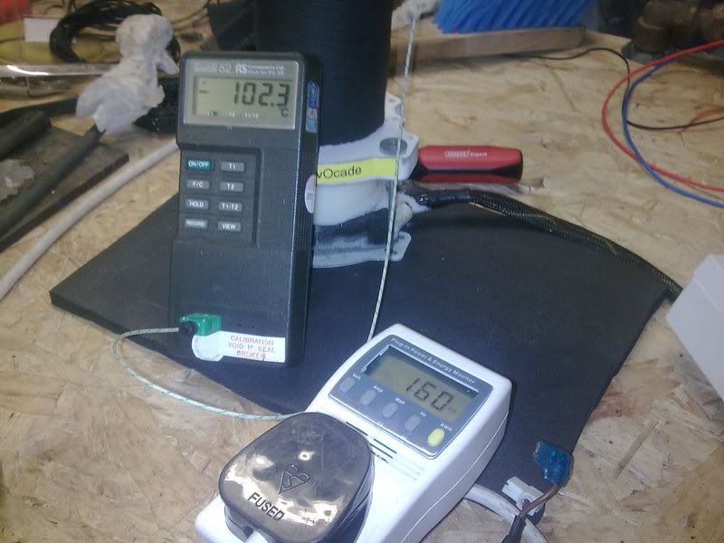

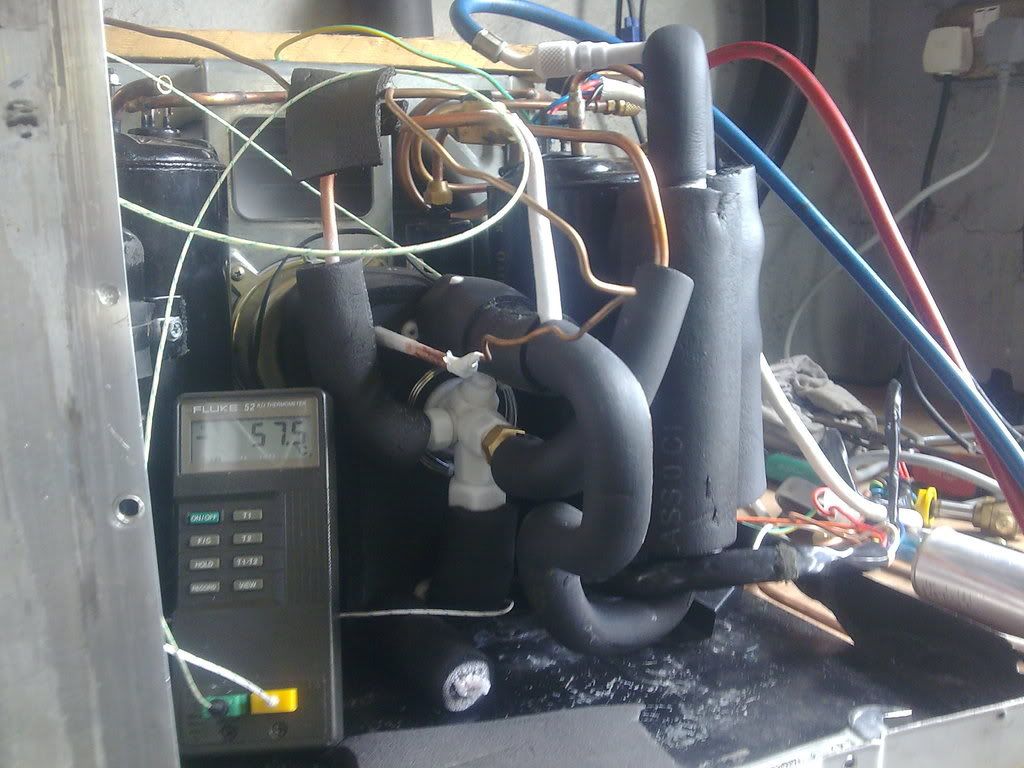

its alive

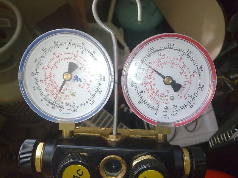

1st tests of the 1st stage are good

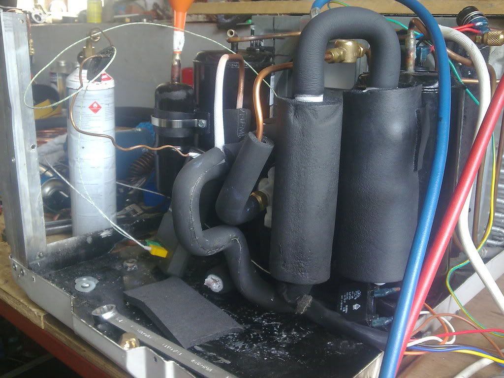

http://i90.photobucket.com/albums/k2...e/Image307.jpg

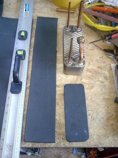

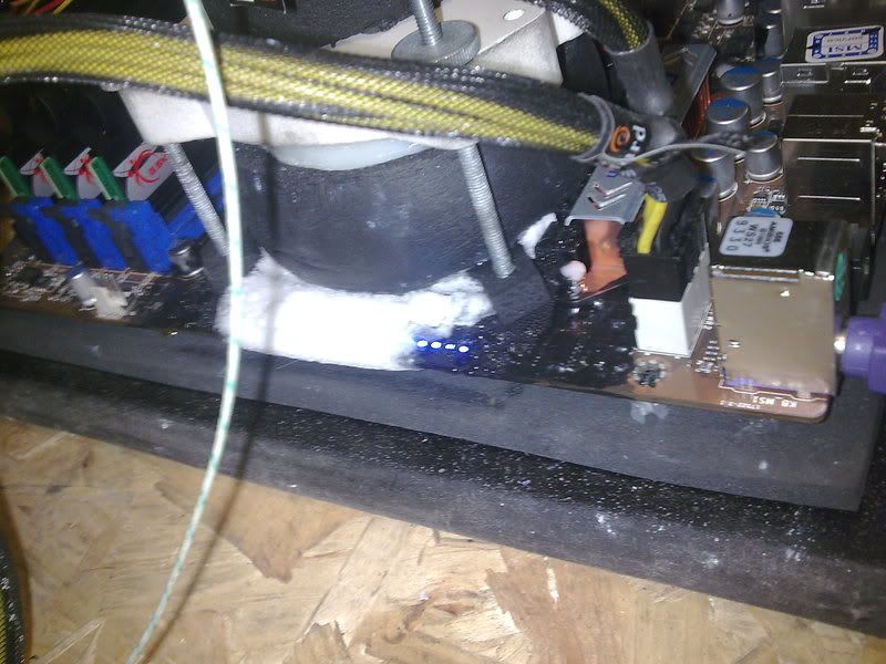

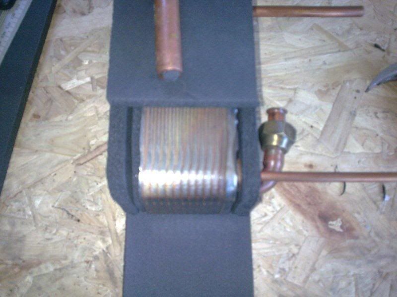

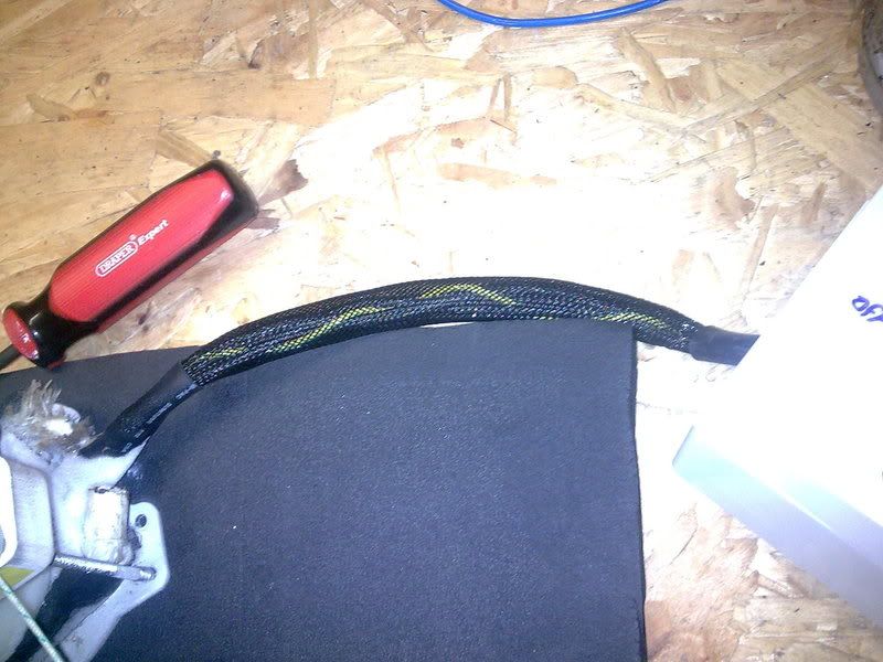

the lagging was fun but the spray gule looks a bit gash
http://i90.photobucket.com/albums/k2...e/Image308.jpg
