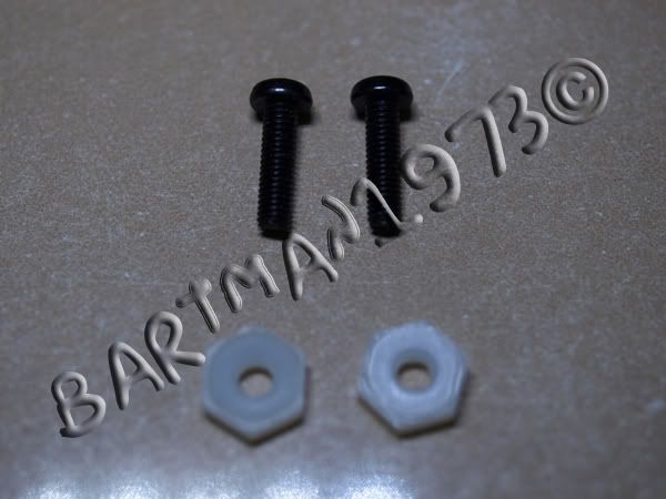

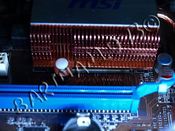

I am a previous owner of MSI eclipse and I have tested the MSI x58 Pro as well. I really hate the split thermal design that MSI implemented on their X58 boards. Engr's in tawian are still saying it is still within the intel's tolerable limit which is 100C ... Well yeah it is but overclockers and enthusiats really hate high temperatures :) so basically i removed the crappy purple thermal interface material that they used and replaced it with as5 ...remove the push pin and spring and replaced it with bolt and plastic nut. added a 40mm fan as well and temps during idle is below 50's while around 60's on 4ghz overclock and load
I cannot find the specific pix for the eclipse but below is the pix from the x58 pro :
http://i669.photobucket.com/albums/v...IOHPushpin.jpg
http://i669.photobucket.com/albums/v...o/IOHScrew.jpg
http://img.photobucket.com/albums/v6...ig/bartsig.jpg
How long are the screws you have taken ?

thermalright HR 05 / HR05 sli i think are better than the stock ... i believe the length of the screws i used was around 1/2 inch or 3/4 inch ... sorry i just took it out from my screw collection :)
