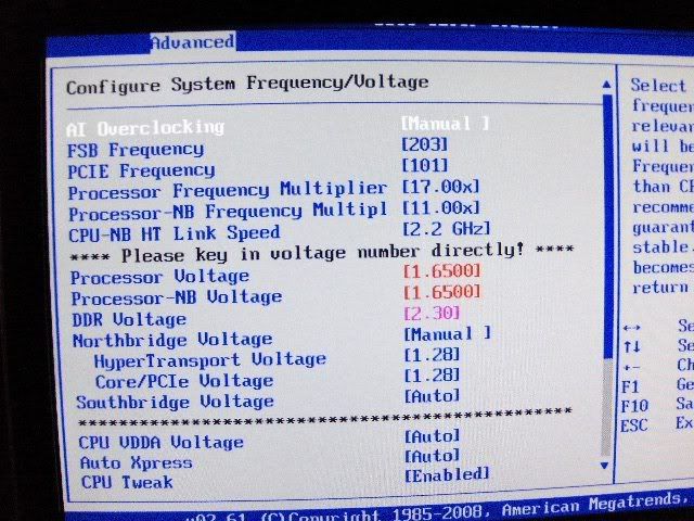

1.65vcore = 1.55vid this is for both CPU and NBvolts
Also see how the Bios Downclocked the Volts in the first screen ,,@ those volts my chip will only be 20c on the TA770..Tha twas the first thing that led me to cranking the volts,,

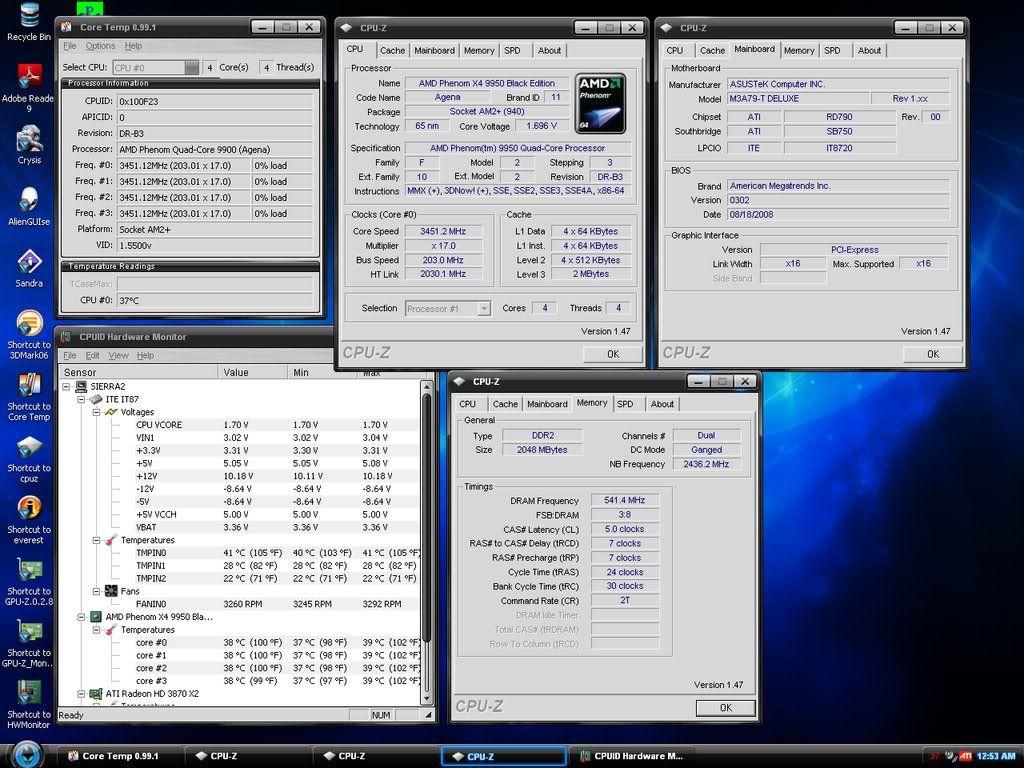

Now look in CORTEMP see the VIDs
@3450mhz//2400+nb is with out ACC @1.55vid,,
@3502 and only 2000mhz nb with +2 and it lowered my VID alot ,,
Using ACC i could not keep the VID's high enuff to run More than 3.5/2000 with out ACC messing up. No matter wher i set Vcore values.

No ACC and my trick of 1.55vid
As you can see @3.5ghz/2600+nb my temps are 10c above what it should be..This same Overclock on my TA770 took 1.55vid and +.038v =1.61volts for both the CPU/NBvid's..
This 79-T is showing 1.7vcore @ 1.55vid's..If i lower the Vcore and or Vids i can NOT run this high..Also when i subtract 10c off my temp values its right in line with what the 9950 does on the TA770.
