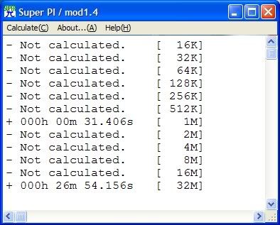

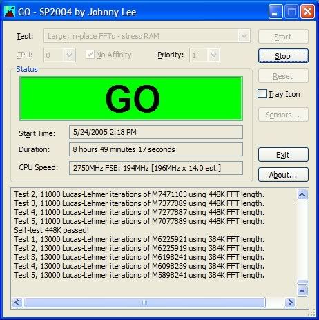

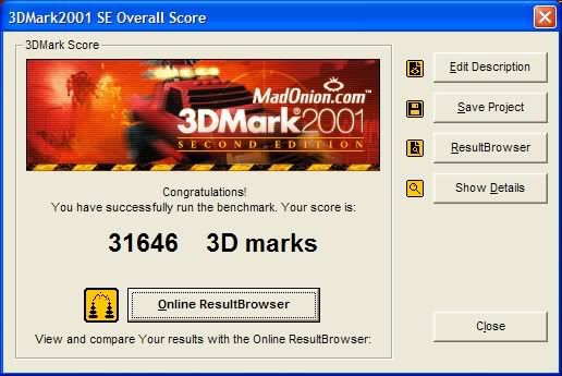

My system is working like a champ, 250Mhz x11, 2T @ Tight, 3.3Vdimm using Hellfire's 510-2 bios. 4 512M sticks of TMII plain jane UTT/VX.
Here is SuperPi:

And my StressPrime:
http://i7.photobucket.com/albums/y29...tressPrime.jpg
And 3D2k1 with X850 OC'd 560/625 on stock cooler:
http://i7.photobucket.com/albums/y29...1X560OC625.jpg
