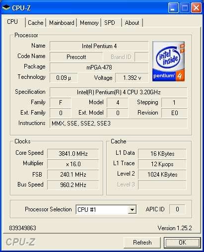

Have vcore set to auto and this is the result I got. Went to go 245 fsb and got errors. Had to remove CMOS battery to reset fsb to 240. Vcore is only at 1.39 in auto so will raise vcore manually to get higher oc. Temps seem fine.
http://img.photobucket.com/albums/v2...101-001718.jpg
Chassis fan : 8598 RPM ! :eek:Quote:
Originally Posted by Shootingblanks
Pretty dern good on 1.39. You should be well over 4 at 1.6v. Please keep us updated, as we don't see a lot of 3.2 E0s.Quote:
Let us know what is top screenie and top stable, if you please. :confused:

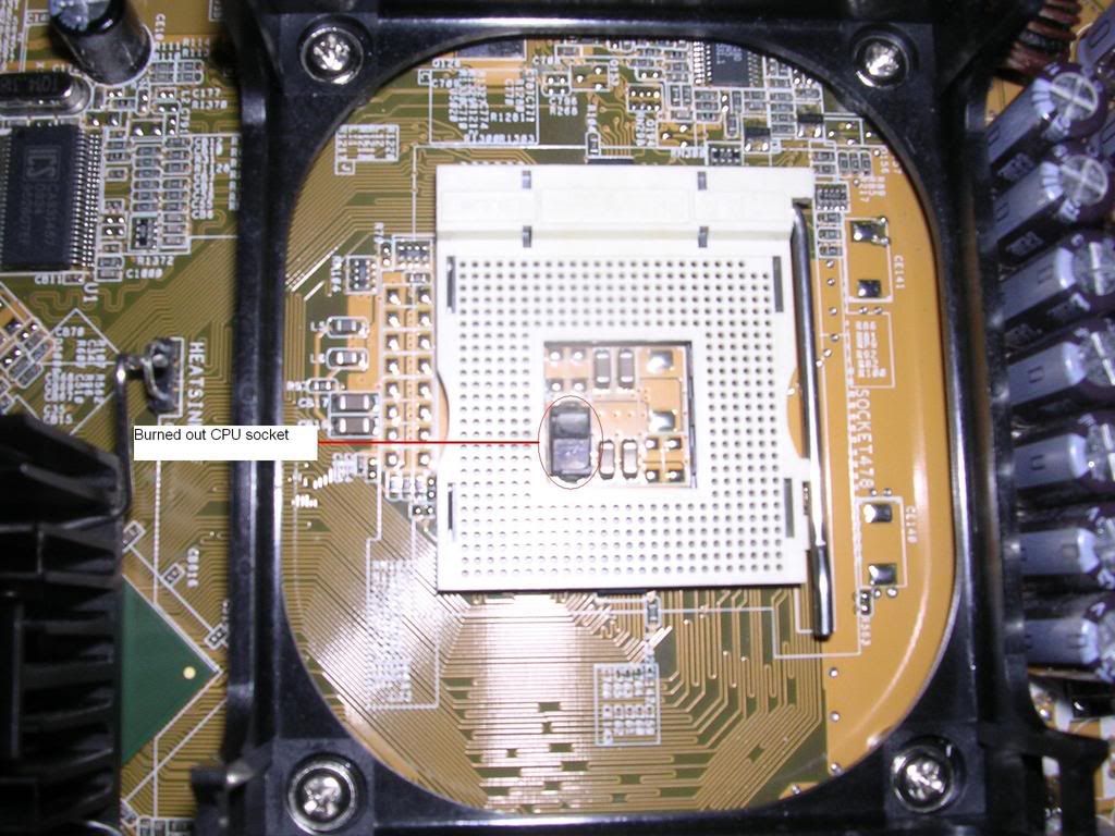

well my stock asus p4c800 e deluxe motherboard took a dump on me. waiting to get a replacement board. sure i can push this processor further. especially since i am running on a watercooling setup. will place heatsinks on all mosfets and do droop mod on new board once i get it. that chassis fan is the fan on my swiftech mcx 159 on my northbridge. well here is a pic of my dead mobo:(
http://img.photobucket.com/albums/v2.../cpusocket.jpg
Ouch! :eek:Quote:
Man, you are making me glad my whole socket is filled with thermal grease.
