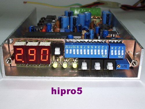

WELL.......NOW guess what THIS does....Warning 56K / photos...

Thank you.....BUT you didn't guessed what this is....!...... :D

Its your DDR 1/2 booster :banana4: !! What do the red/green LEDs correspond to?

Booster OR " Maximizer " ??........ :D
I'll explain later on...... ;)
looks like vdimm, vcore, and vdd maybe?

:D You can get this NO MATTER what PSU you have.......Not maybe 3.8 or 3.9 or 4.0 or 4.1.......STRAIGHT = 4.22Volts..... ;) :D

I may be blind but.. how does it plug into the motherboard?
does it track vtt for non-vtt tracking boards like the IC7?
Don't be so fast.......Wait......You'll see.....This is the front Panel.... ;)
Yes it does...... ;)

i'm not sure if everything was implememnted that was talked about in the previous thread but that's what it looks to me like:
DDR Maximizer with "vtt tracker" and maybe "Vcore Maximizer" built in :) and it might connect from one of those green connectors to PCB that is inserted into DIMM slot... i just wonder what is that other wire that comes out of it... maybe the one that one solders to Vcore IC so the Maximizer works wonders for vcore too :)
EDIT: no, i was wrong... no Vcore Maximizer :(
- first 2 posts show how it raises vdimm with switches
- next one shows MIN and MAX using trimmer - switches OFF
- next is VTT tracking
- next one shows raising vdimm on DDR2 up to 2.4V
- and the last one shows vdimm on DDR2 at 3v (!) with trimmer.

nein
its either vdimm for DDR, and DDR2,
or
vdimm, and vtt
yep, vdimm for DDR. then VTT and DDR2 :)

EXACTLY what it does...... :D :toast:

What would be required for us to fix the VTT track, I mean do we still have to mod something on the mobo? Or is it just plug in the molex and plug into the dimm for it to work?
Excellent work :D You'll have my money when its available ;)
According to the other thread, yes
The reading on the front panel, is that the intended voltage to be given, or the actual voltage being given to ram.

For fixing the VTT track the only thing you have to do is........PRESS the VTT switch to ON.......Not that hard I think....!...... :D
It's the ACTUAL voltage being given to Ram (Vdimm or VTT)........It measures it's output...... :)

Some technical info :
Can produce up to 4.22 Volts and up 2.11 Volts separate each other.....
The - max - 4.22 Volts line can produce 25+ A (actually 29 A)......and 34+ A at 3.6 Volts output......A total of 125 Watts power for this line......
The - max - 2.11 Volts line can produce 18+ A (actually 19 A)......and 22+ A at 1.8 Volts output......A total of 40 Watts power for this line......
They are both short cirquit protected and overvoltage protected....
The mainboard(the one on the photos given above) is also thermal protected by it shelf......
At load of 25 A one line and 6 A the other line , it produces about 52 - 54*C of heat.....We are gonna play with 12 A and 3 A max with 2 x 512MB Ram sticks so you'll encode no problem..... ;)
You can feed with this thing , TWO computers at the SAME time , thas 4 x 512MB Rams sticks......It's capable of giving this watage with "joy" IF your PSU's 5Volts line is strong enough to feed it..... :D
NOMATTER what PSU you have , you'll get the max 4.22Volts for REAL and NOT maybe 3.7 or 3.8 or 3.9 or 4.0 or 4.1 or we will see......You'll GET them...... ;) :)
The whole box will be a 3.5" bay and it will consists of pure alouminum of 1.5mm fatness which will be the heatsing as well as the masiff aluminum where the transistors and the Mos-Fets are screwed on......
That's for now......and we will continue........ :D :toast:
E D I T 1. : The front panel face will be in black and alouminum Lian-Lee colors - anodized......
The PCB's will be black with gold(or something like that) letters and components drawing......
E D I T 2. : The MAX voltage faulse at full load a.k.a. 25 A is 10mVolts...... ;)
I found it :D
It's a rev 1.00 hipro5 magical device.
I could say it looks like a μουλτι...κο...ρ :D
I believe i just won the 1st retail device :toast:

Final release will be out soon........First we'll do some beta testing and get a CE (European) certificate so as we can sell it in Europe.......In the meantime we have to get some other certificates for International selling as well so as to sell worldwide......One step at a time.......Europe of course will have it first and VERY soon I suppose....Other countries users could buy online off course via an online European shop and fortunately we have offers for resellers all over Europe..... :D
WTG Hipro! Do you know if the "maximizer" will be able to get around the over volt protection that the asus a8v has? The ovp kicks in at 3.1v on the vdimm. I would love it if it did!

Unfortunatelly NOTHING can interfear and disable any OVP ..... ONLY mods will....... ;)

Looks beautiful... Have you done any testing with it and 2x512 sticks on motherboards to see how well it works? If it feeds/reads through the dimm slot like the OCZ booster, I noticed it KILLED my rams overclockability on both boards I tried it in. (Even with 3.2vdimm, ram couldn't clock as high as with 2.8vdimm).

Question, it must be a 5.25" bay right? if so, is there going to be a 3.5" version? cause if there is I'M THERE BABY!!
Blue LED + Silver Lian Li Cover = L337!!!!
Check the pics man one is sitting on top of a floppy drive and it looked the same size to me. Maybe I looked too quick. Either way the answer is there.

Its 3.5" he says it earlier.
