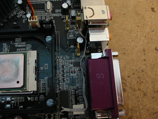

i using this mod for long time on my is7-e rev1.2.
i picked up an ic7 and mod it too.
the mod is not really needed, but... xtreme

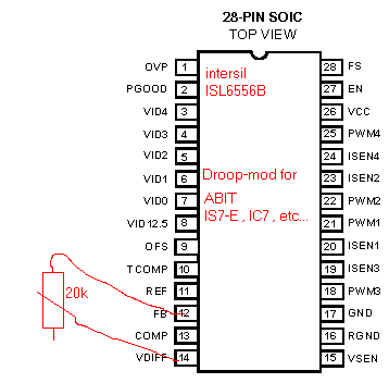

the mod works for the Intersil ISL6556B
simply connect an vr 20k (or higher) between FB (12) and VDIFF (14)
attention and findings:
- bevore first boot up make sure the vr is turned to the max settings.
- with lower resistance, droop is smaller but vcore rising... watch out...first slow an than faster and faster... turn slowly
- on ic7 the mod works a bit better, load=idle is possibly, on is7-e the droop are smaller but not idle=load
- the original (unmodded) droop on is7-e is higher as on ic7.
- this mod worked not ok on max3.. read the posts..
