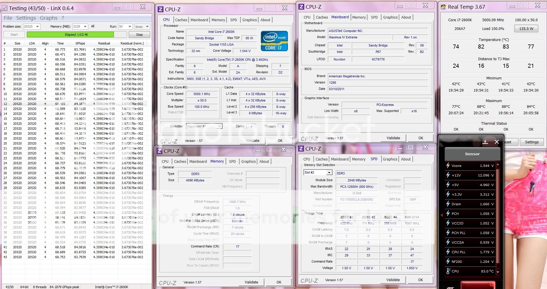

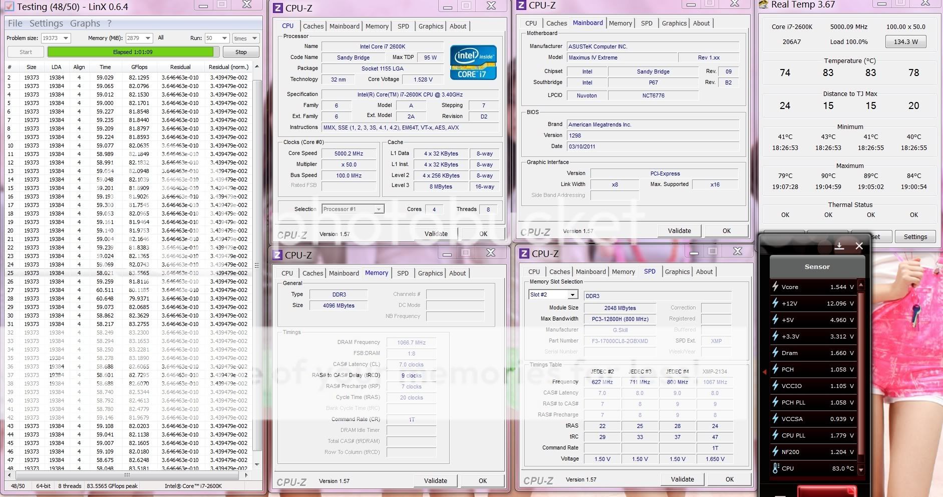

Not that I find it makes a lot off difference in real life but I've pulled my set in as tight as they will go for 24/7 running at 2222MHz, cant remember the settings off the top of my head but I'll post up my UD5 settings later if you want.
I run 2133 @ 1.58 & 2222MHz 1.64v with the below settings

Edit: Corrected timings
They make this in Super PI & AIDA
