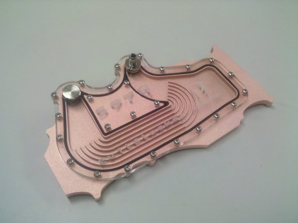

Here is my Dangerden 5970 Final Version.. Result tommorow
http://i620.photobucket.com/albums/t...-02_143351.jpg
pictures of the underside...before intalling..
The additional water channel looks so much like an afterthought.
Honestly. You dont really need the water over the VRM.. the block I got now doesnt. and my VRM stay cool enough....

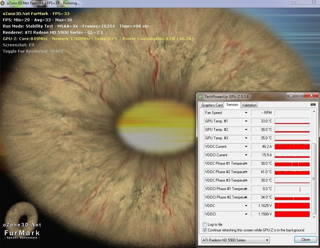

Yes it does.. Here are the results this is 850core 1200mem 1.165 vcore and 1.15 on the Ram
http://i620.photobucket.com/albums/t...ttle/58702.jpg
Good results. Dangerden block you say?
Nice results but the blocks are hideous they could put some effort into the looks.
Nice temps :up:
Hi Evilclocker! Can you post a screen of maximum OC load temps on the revision 2 block?
Sure..
You should try running fullscreen and without aa. The draws more current in those conditions. My card will draw around 70 amps. See what temps you get then.
