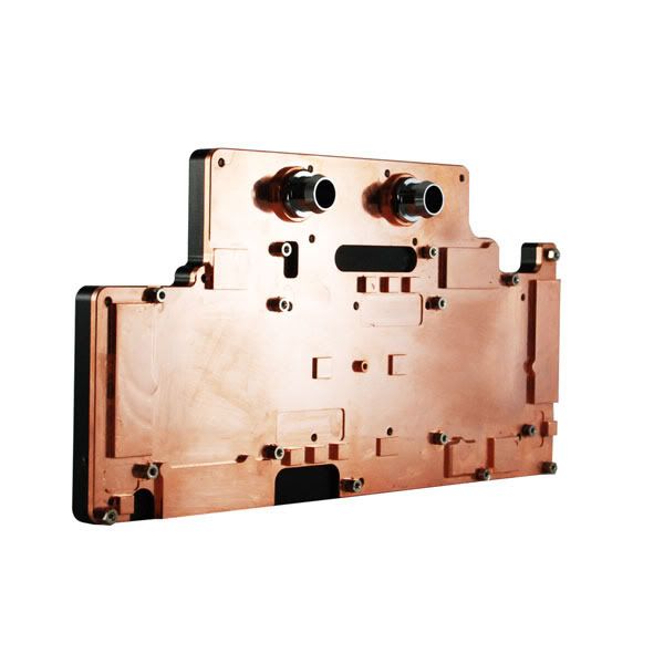

OMG WTF is eVGA thinking...
this picture sum's it up:
http://www.itx.ba/images/stories/Rec...oren-skroz.jpg
This could be the OEM innovotek block... maybe...
Not to mention the seal and all of the screws! That is a nightmare.
that block looks like its starting to corrode.
Parts of it is a tintish green, and i see pits starting to form in areas.
YUCK...

If eVGA's instructions warn people to use special coolant with the block, they don't have to recall. I'm looking to see if there's a product page for the card or block, but nothing so far.
Ideally, the block should be pure copper. Better performance and it removes any risk of this happening. Maybe they used aluminum because there were a lot of complaints about their 260/280 block being WAY heavier than it needs to be?
Besides, it's not called Hydroalucopper, it's Hydrocopper.
by mixing metal they should recommend a special coolant, one that prevents corrosion.

zlojack,
The GTX 285 blocks are gorgeous in my eyes and most definitely solid copper (alike but different from the GTX 280 blocks). I'm buying those.
it looks like nickel-plated copper that had black coolant run through it.
i present to you
INNOVATEK.. cool-matic GTX 295...
http://www.webshop-innovatek.de/shop...01426_2_z1.jpg
http://www.webshop-innovatek.de/shop...1426_2e_z2.jpg
http://www.webshop-innovatek.de/shop...1426_2f_z3.jpg
http://www.webshop-innovatek.de/shop...1426_2d_z4.jpg
looks like the only difference between the two is the copper base... :( sad sad sad
Well, evil beat me to it by 5 minutes but yeah, that turd has Innovatek's crappy machining and flow pattern written all over it.
yay i win! wheres my cookie...
yea the way it was design it was obvious that i was made by innovatek.
atleast we can say that EVGA made a bad decision and that it wasnt there fault entirely.. :shrug:?

Don't know what's wrong with metal mixture in a loop. Had loops working for over 2 years with blocks from Innovatek in Aluminum and EK in Copper and never ever had a single spot of corrosion. It's all in the cooling fluid...
Anyway, back on topic... That product should have never been advertised as Hydro Copper, it's fooling the consumer and we all know Copper is a better heat conductor and works better (and is more expensive as well) than Aluminum. Looks like a fail :down: to me.
Pretty sure it's out there somewhere.
http://www.archive.org/web/web.php
+1
You can mix metals just fine as long as you don't as you you use proper cooling fluid/additives. I mean every other car cooling system mixes metals, and they seem to be doing well...
Lots of people are also running Innovatek and Aqua Computer alu stuff with copper blocks and it works just fine (as long as they use proper additives of course).
I'm not saying that alu is good, but it's definitely usable in a WC setup.
Selling that block as Hydro Copper is deliberately misleading customers though, they should have never done that. Also, if someone sells alu blocks they should provide sufficient information on what corrosion protection should be used, which EVGA seems to not be doing considering the look of the block in the pics :down:
EVGA has been selling video cards with Innovatek blocks for years in Europe. Considering this there's no reason to doubt this. Also Fud is not really known for faking reviews, they may often provide dubious rumors that turn out to be wrong, but they don't fake reviews.
These additives are called corrosion inhibitors. Not corrosion blockers. Galvanic corrosion cannot be halted by adding in compounds, only slowed - any mixed volatile metals in a loop will cause corrosion. In order to fully protect yourself against any corrosion within the usable lifetime of the products, you'd have to add so much corrosion inhibitor to your loop that performance would suffer a huge hit - and you still couldn't guarantee anything.
Mixed metals are definitely not "usable", unless you like gambling with your hardware, and especially not when there are Cu variants available for more or less the same price.

As much as I hate mixing metals, I gotta disagree with you on this. Mixing metals is not ideal but "OK" with the proper corrosion inhibiter. Adding more corrosion inhibitor than necessary will not extend the life of your product. A product's life cycle nowadays is what?....6 months to maybe 2 years max? I agree, you _will_ lose out on performance from using coolant instead of straight distilled but the drop will be minimal for most users.
That being said.....mixing metals in a loop is one thing...mixing metals in a single block is another....what a piece of crap....
How do you explain that people have been running mixed metal loops for years with no problems?
Why do the radiators and other parts of the cooling system in cars work for dozens of years if corrosion is such a problem?
Because of the "don't mix metals" hysteria on XS you don't find many people doing it here, but many German companies have been selling alu stuff for like 10 years now. How do you explain that these companies still exist if their products are not usable as you claim?

If anyone wants proof that alu and copper mix fine with proper additives they just need to take a look at Aqua Computer's forum...
Again, I', not advocating the use of alu, I'm just saying that using alu and copper in one loop without getting corrosion is easily possible.
Aqua Computer used to a sell an optional copper insert for their 8800 GTX full cover block. The text accompanying the product basically stated that it comes as is. Use it at your own risk. We won't be held responsible for corrosion problems. Somewhere on their forum there was a customer with a messed up block as well...maybe it's still up there...Quote:
As for personal experience, I once had an aluminum anodized reservoir by them. Used it according to their instructions with ACfluid. After several weeks corrosion had already started in the fitting threads.
After that I cleaned my system out and I ran the same setup; full copper with an acrylic reservoir instead for 1.5 years without any trouble whatsoever.
Most mixed metal blocks are usually plated or anodized which also helps lower (but not completely eliminate) the risk of corrosion. Once there is a nick in either, it's all over except for the deterioration. This turd was neither plated or anodized from the looks of it.
I really have to laugh at the comparisons to the automotive industries use of mixed metals. Most auto's use a 50/50 mix of water and anti-freeze (corrosion inhibitor) which is far higher than anyone should use in a computer due to the thermal transfer rate taking a very serious hit. This is the reason for such longevity without corrosion. Maybe that's the reason Innovatek Protect is so good at holding corrosion at bay...and why the temps are crap.
Evga has sold cards with alu blocks for years, ever since they teamed up with innovatek back then in the 7800 days.

I think this new block looks pretty good. "Undisputed" or not, I'd take this over the similar Danger Den/BFG card.
I do think BFG is the Undisputed champ at overpriced water cooled video cards.
