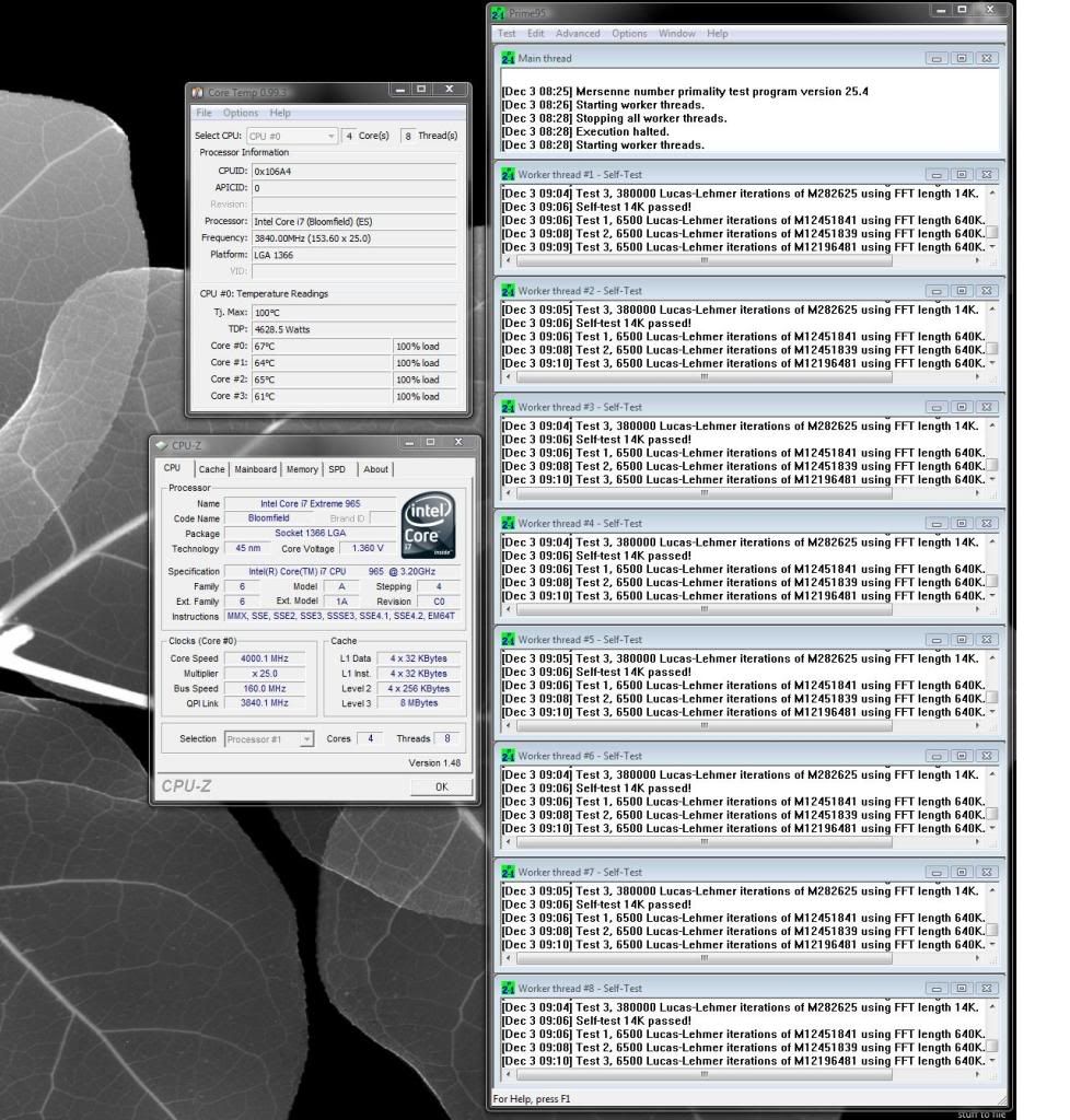

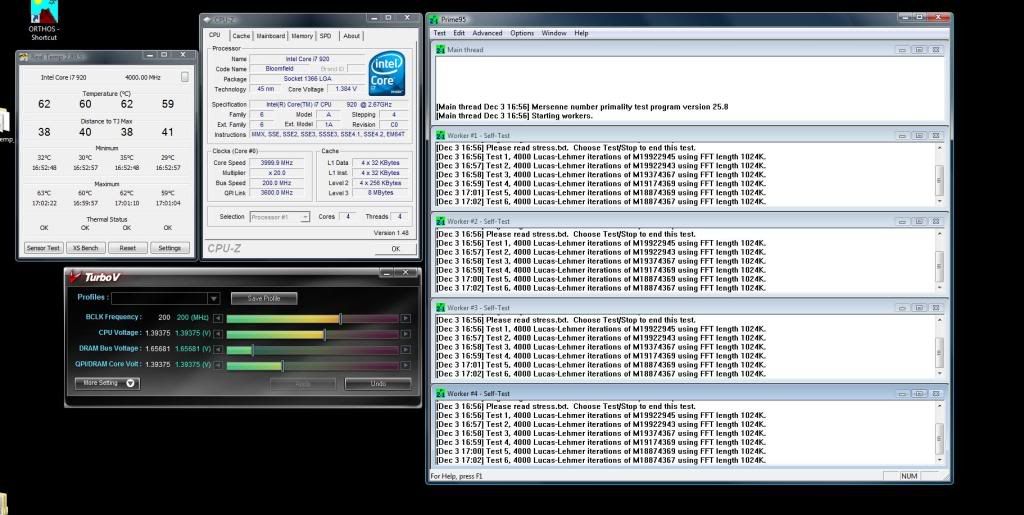

so I did a prime run @ 4.0, 1.36v, HT enabled
this is on water with a GTZ, mcp355 w/ petras top and thermochill 120.3 w/ 6 fans in push pull config on the front of my MM case sucking cold room air
ambiet is around 75f
http://i37.photobucket.com/albums/e8...ander/40ht.jpg
for reference here is a prime run at 4.25, 1.46v, HT disabled
http://i37.photobucket.com/albums/e8.../4250prime.jpg

This is with mc-tdx cpu block, 2 mcw60 gpu blocks, mrc320-QP rad with 3 s-flex 1600rpm fans and a ddc 3.2 pump.

40-45c idle, 60-65c load 4.2ghz.
1.344vcore under load.
made 7hours prime 4 threads.
