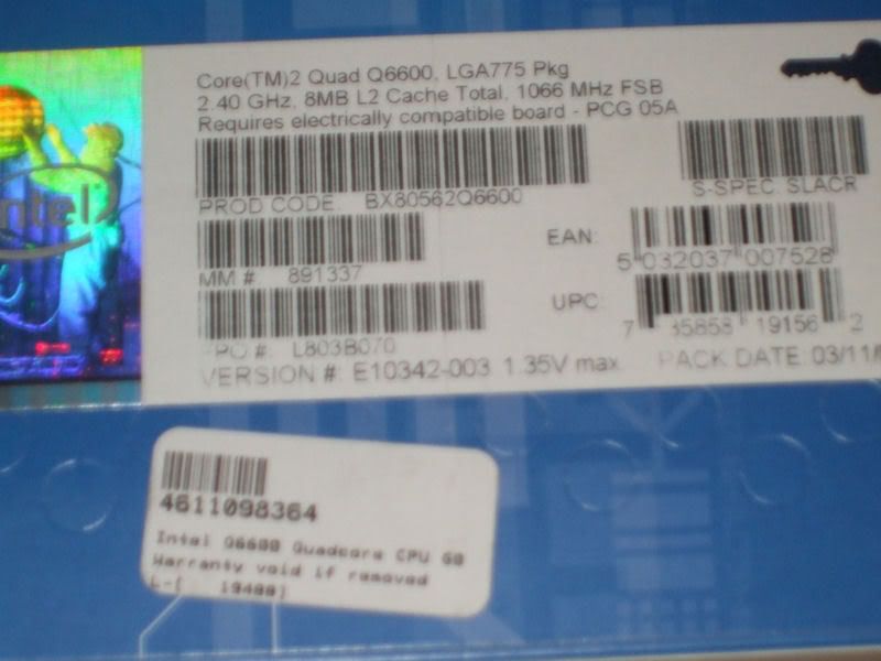

hey guys, i just got my g0 finally and its an L803 batch?!
i really never seen a g0 thats L8 anything so if anyone has any info on how well mine may clock that would be great..

do all cpus that have the same 4 letters starting have the same vid? mine is L803B116, while the one in the forum is (you can see in the picture) L803A484
That appears to be a tray version on the German site. General consensus is the boxed versions are binned a bit better (center of the wafer, rather than edge).
The poster is complaining about the vent hole on the IHS.
In any case I wouldn't worry about what the box says too much as mine (batch L738B024) said "1.35V max" on it but I have it running at 3.2ghz w/ 1.26V 24/7 100% load, temps 50-55C using the questionable Asus silent square air cooler.Quote:

tray means oem with no cooler right? mine comes with HS.. maybe i should try to post a pic of this box

If you want a pic of my box.. here it is...
My Camera isn't manual focus, so close up pictures are really blurry...

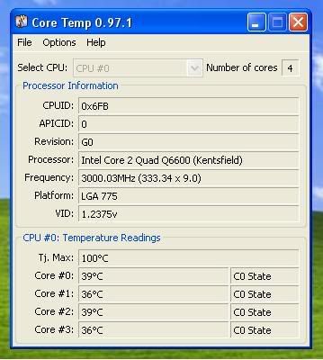

OK, I installed that oem I got from newegg, batch L738A357 VID is 1.2375

Hi everyone, i just got my q6600 today and its one of the new dark blue boxs its an L803 but without the weird hole thing, i just checked in core temp and its got a VID of 1.2375v, i dont no much about these q6600`s as its my first quad, is this any good?, its at 3ghz at stock volts and intel fan right now, im gonna fit a scythe infinity + 2x 120mm 92cfm fans and go for a higher oc.
http://i280.photobucket.com/albums/k...l/coretemp.jpg
http://i280.photobucket.com/albums/k...eeezl/quad.jpg
That is a pretty good VID. My L803 has a 1.300 VID and needs 1.49V to get to 3600mhz.
