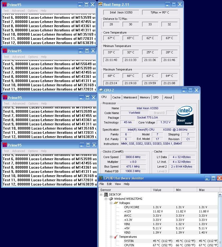

Mmm tasty, 3.8Ghz at ~1.3v. That's a hell of a lot better than my Q6600 B3's 3.5Ghz at ~1.5v :p:

Well, thing is... I can't go any further than 475 and stay stable for long. At this point, I think it's the motherboard that is holding the chip back. Watch the video and you'll see that it's completely possible to POST at 500 but it won't go into Windows no matter how high the VCore is set.
Edit: Oh, and I lapped my chip today, too. Idle temp dropped by 10C and load temp dropped by 5C after lapping both the chip and the ACF7. When I lapped just the ACF7, idle temp dropped by 5C and load temp did not drop at all. And beware, at 1.35V, this chip can really heat up to 80C (with Prime95 small FFTs) when you don't monitor her.

I'm currently on air, and it's 3.80GHz stable. Temps can reach 70C sometimes, though... and definitely don't try Prime or stress testing too much at 3.80GHz without TRUE or some high-end air cooling, lest you kill your chip.

Actually, it's only completely stable (Prime95) at 1.328V to 1.344V (1.335V and 1.350V in BIOS respectively). At any other settings, it might BSOD or crash every hour or so if I'm doing something intensive. But I'm happy nontheless, I've seen initial retail Q9450 results that need 1.350V (1.375V in BIOS) or even more to be stable for 3DMark06 only. And I think none of them could even POST at 500 x 8 so far.

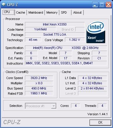

Hmm... 490MHz is also bootable! :)
http://i235.photobucket.com/albums/e...C/X3350490.jpg

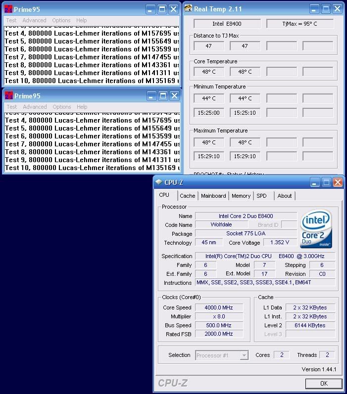

I'd watch that vCore if I was you. The 45nm CPUs (at least the Wolfdales, and I doubt Yorkfields are much different) have a habit of dying if given much more than about 1.45v actual for 24/7 use. I personally wouldn't want to be using more than about 1.4v actual with a 24/7 rig.

Thanks for the reminder. Someone said the same thing to me when I bumped my E8400 to 4.65GHz the other day. I'm just posting a validate for 4.00GHz to show that there's really... no such thing as a 480FSB wall for this CPU. Of course it's not a matter of VCore, since I can also boot into Windows at 4.00GHz with 1.35V (just found out). The problem is that the strain on the motherboard at 500FSB is too great for it to maintain stability over long-term use, so 4.00GHz is really unrealistic, and not just for the vCore it requires.Quote:

P.S.: And this chip is showing weird signs... of voltage requirement. It required 1.344V to prime stable for over 4 hours just yesterday. Now if it's degraded, it should require more, right? Today, it's requiring only 1.320V to prime stable for 7 hours straight. Slapping a Big Typhoon over it cooled it down drastically, too, and now I'm hovering at 20C-55C in normal office works and gaming sessions. Also to note that 475FSB no longer required me to boost the PLL and FSB termination voltages. I can leave them at stock now, and instead, just bump the northbridge voltage to 1.55V and it's rock solid. I have a Thermaltake Extreme Spirit II on my northbridge chip so I'm not afraid of temperature... but... that's just plain weird. Just yesterday, it required 1.64V PLL and 1.40V FSB Term to stay stable at 3.80GHz!
And... 480 FSB wall is busted. :p
http://i235.photobucket.com/albums/e...C/MaxBench.jpg
That's 3.92GHz stable at 1.44v... so if I'm not mistaken, it'd take 1.52v or 1.54v for 4.00GHz stable. vCore for frequencies are as follow:

That's a killer chip you have there. 490 x 8 at 1.44..... when you say stable, you mean prime stable right?

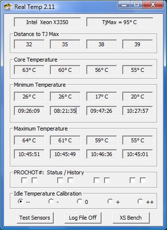

Edit: Here are the temperatures when the processor is idling at 3.80GHz... and when she's being stressed by Prime95 large FFTs, me playing some Youtube videos, loading these websites, chatting on Yahoo, and MSN, and probably... uploading something via Torrent all at once:
http://i235.photobucket.com/albums/e...am/PC/load.jpg
Idle: 26/26/17/20
Load: 64/61/59/55
All on AIR with a Big Typhoon.
This is just so you know what you can expect from your chip. :) Ambient temp here is current 23C.
