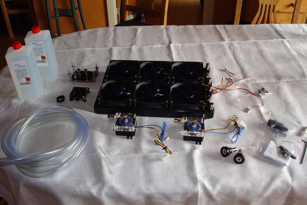

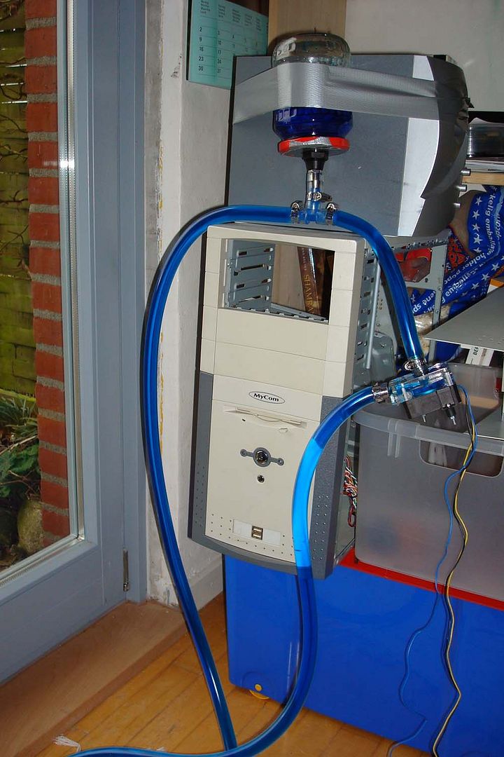

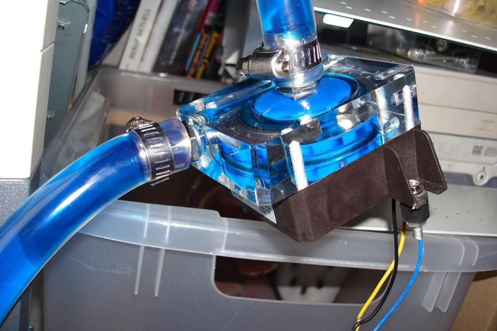

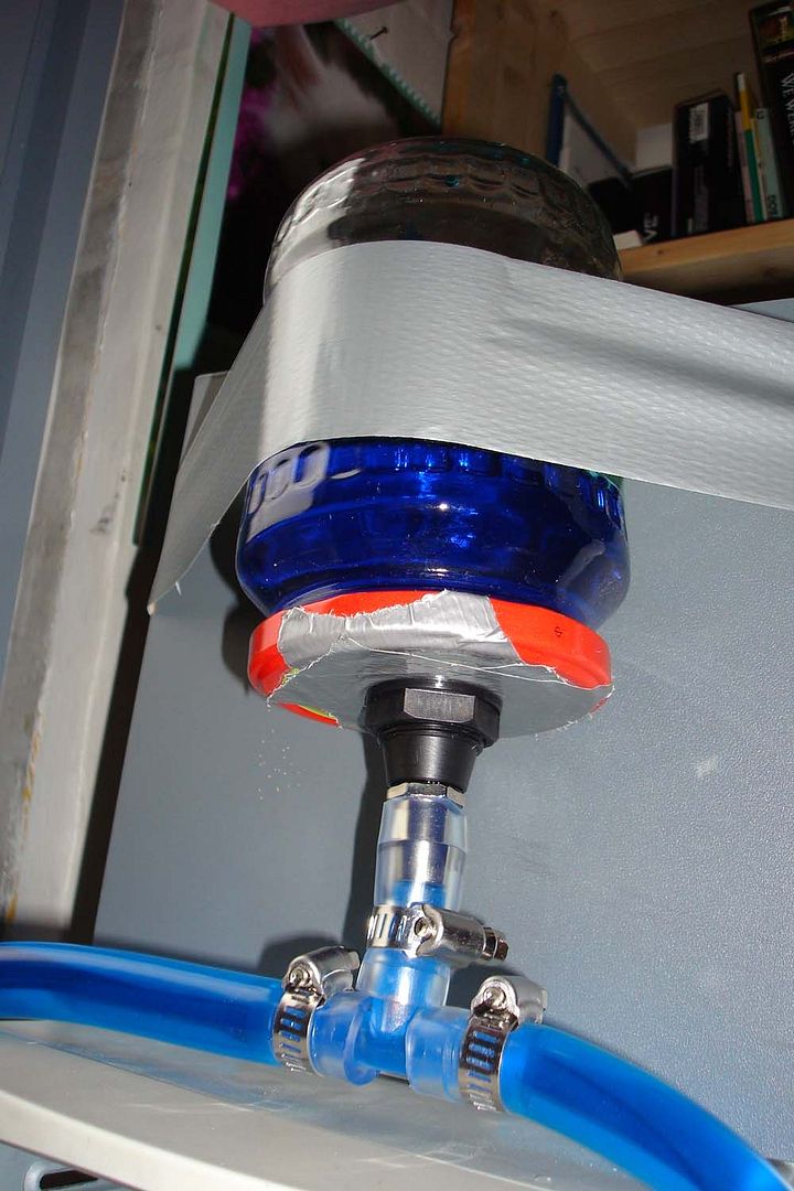

I have been testing the first pump for a hour i think, it runs nicely (and xtremely quiet compared to that of a Bigwater 745 xD) and i will be leak testing rads and so on in the weekend... I really like my homemade testing res^^ a fillport, a drill and a old glass :D
some pics....
