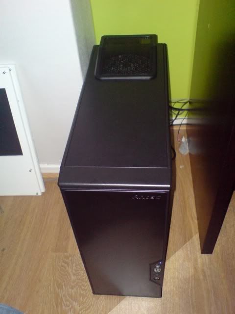

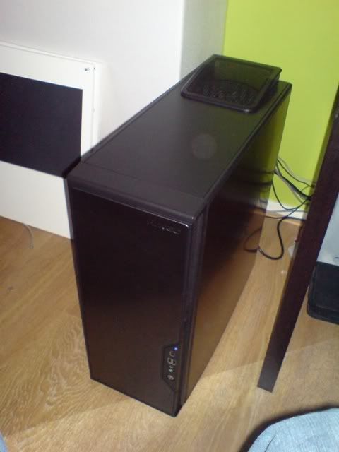

    I painted the case, made some more cuts, and installed some of the parts too.
    I also flushed the rad with boiling distilled water.
    Enough writing. Here are some pics:

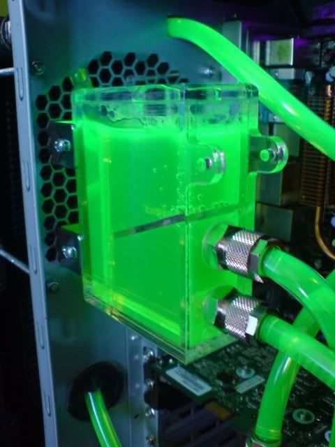

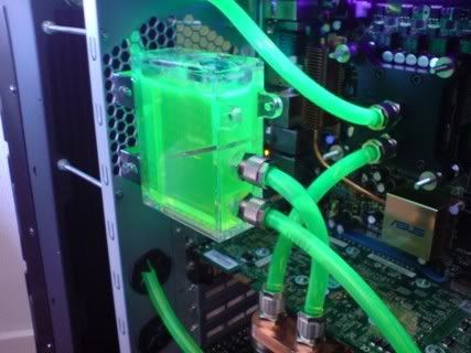

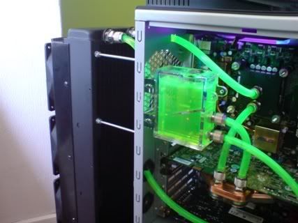

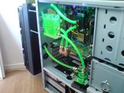

    11-05-2007
    Finally it's time for a new update.
    I am more or less done with everything now. I just need to Vmod the videocard. But i'll wait a bit with that.
    I also bought a new chip as the E6400 i had was a terrible clocker. It needed 1.55 volts to run at 3.4 GHz.
    The new one is a E6420 L644G which currently runs at 3.6 GHz at 1.49 volts. I am not done with fine tuning the clocks yet.
    Everything is up running now and i have had no leaks so far :)
    The loop was extremely easy to bleed. I just let it run for 15 mins and all air was up in the reservoir. I had to fill the reservoir up several times though to avoid getting a vortex in the res which sucks air into the loop.

    I dropped using the bracket that holds the reservoir. It hangs fine from the fillport.
    http://christianlykke.net/Lasse/Comp...52_600x800.JPG
    http://christianlykke.net/Lasse/Comp...54_800x600.JPG
    http://christianlykke.net/Lasse/Comp...55_800x600.JPG

  • 06-30-2007, 01:00 PM
    lasse.j5
    Originally Posted by sandoz View Post
    looks good :)
    can you post some pics from the finished case?
    Thanks. The last pics are more or less of the finnished case.

    NEW UPDATE WITH LOTS OF PICS!
    Originally Posted by Polizei View Post
    Still waiting for most of the pictures to load (stupid slow connection), but this is what a true worklog is... Lots of pictures.
    I know the server is slow but i doesn't get any better than that. Have patience is all i can say :)
    Originally Posted by MaxxxRacer View Post
    Wow. That is the cleanest watercooled P180 I've ever seen. Very nice man.
    The only Concern I have is for the mosfets. As you have it now, they have very limited cooling.
    Putting the NB/SB on the thermalright heatsinks as well as the Mosfets will really help out though.
    Thank you for the kins words. The new heatsinks have helped alot. The old heatsinks were scorching hot to touch. The new ones are very cool to touch.
