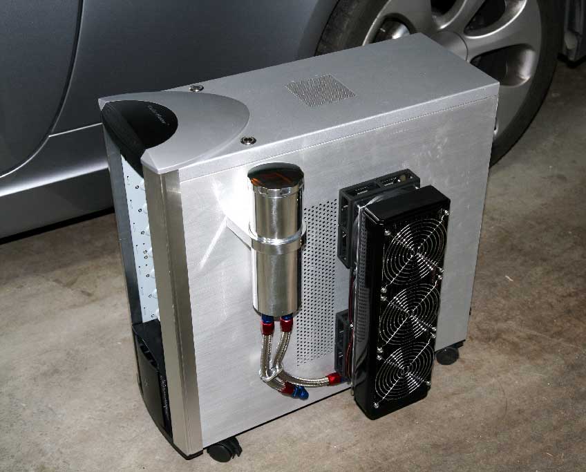

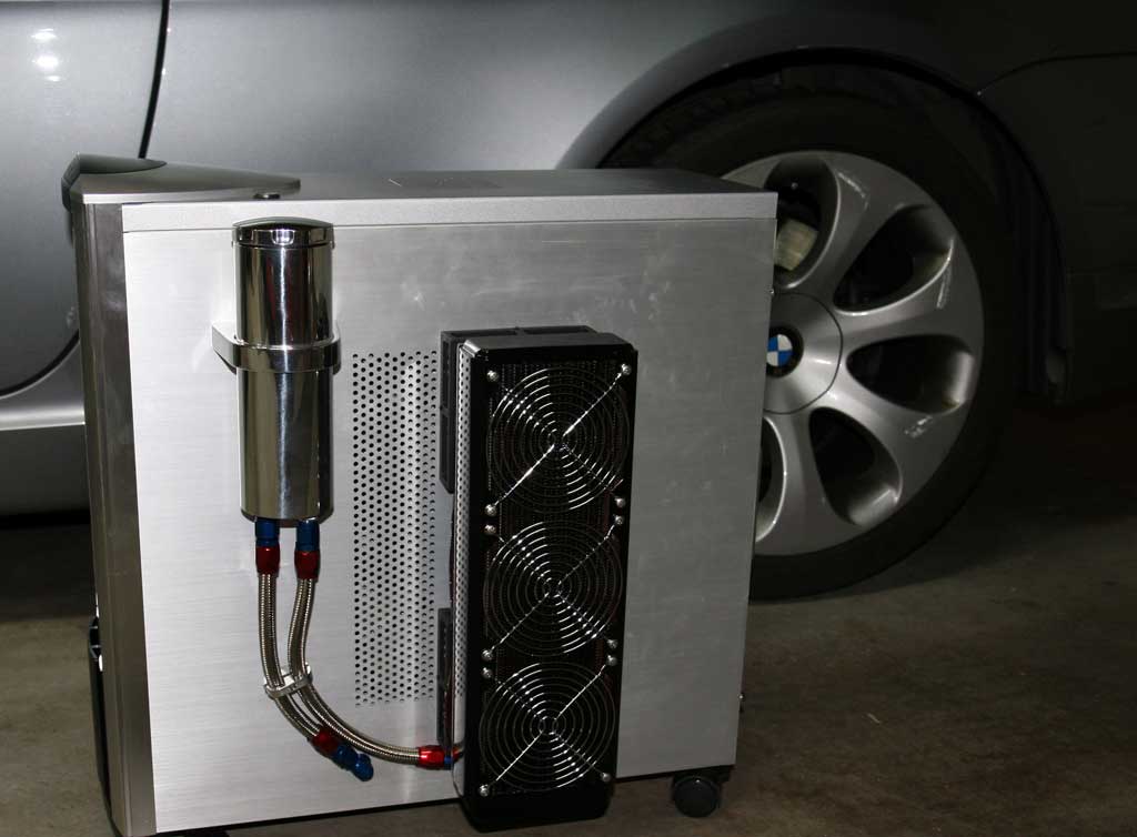

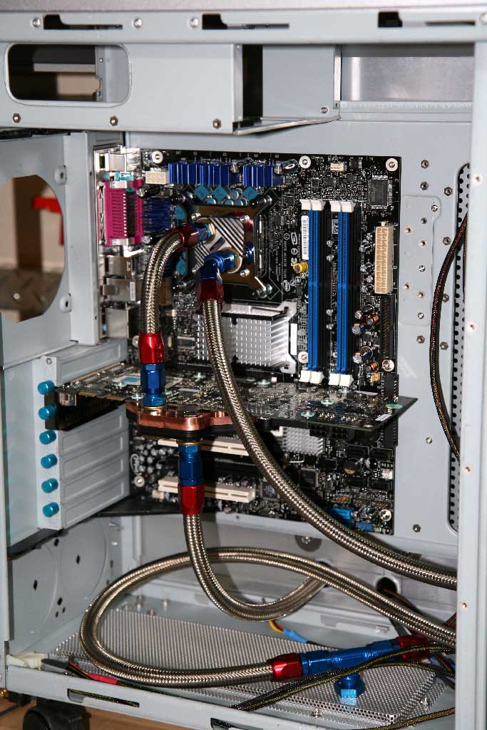

Yep, but these are industry-standard fittings, Russell is just the best manufacturer. Some of the other fittings I used in the setup are from Earl's (a division of Holley, as in carburetors), Aeroquip, and a little outfit called Kinsler Fuel Injection. All AN fittings are interchangeable.

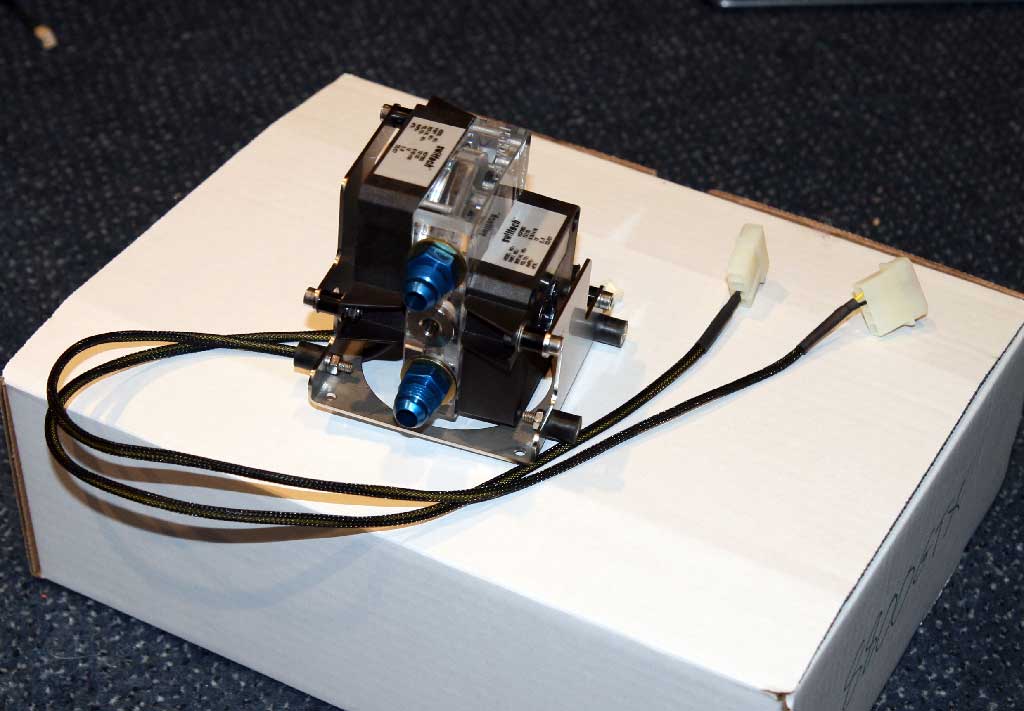

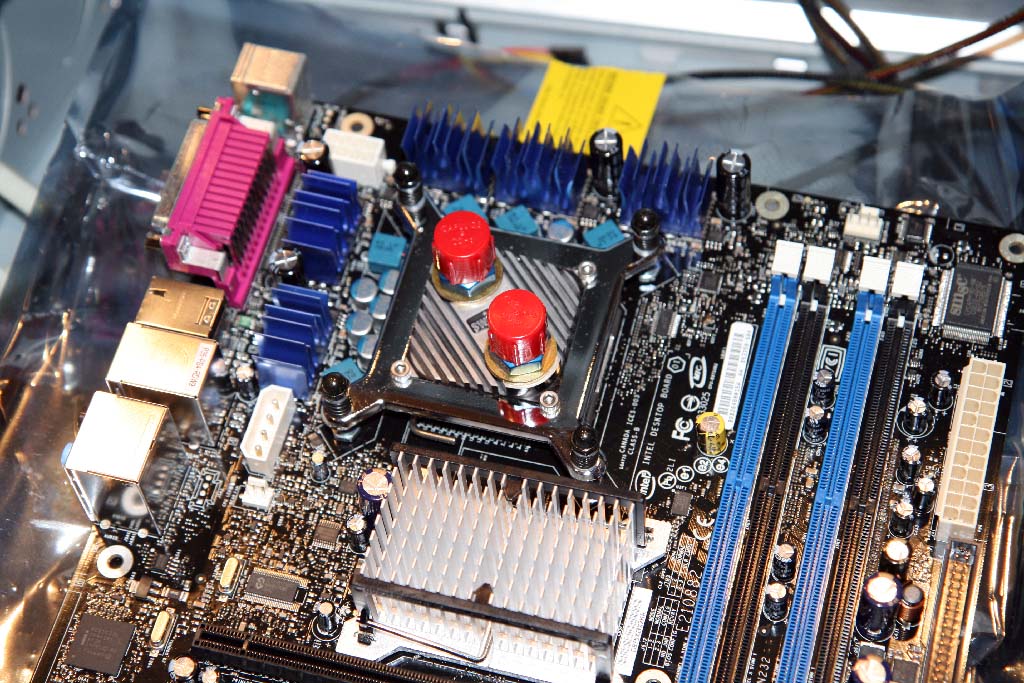

The fittings for the water blocks are G1/4 to -6 AN adapters, which are almost impossible to find. I got them from
www.kinsler.com part # 8280 (here I am giving away my secrets :) now everybody's going to be doing braided lines).
These are heavily anodized to withstand much harsher environments than PC watercooling (e.g. gasoline, diesel, nitro methane) so I have confidence in the galvanic corrosion situation. Just to make absolutely sure I'm going to be adding some Pentosin.
Well, there is no way to get them at a reasonable price (LOL) but the place to buy is
www.summitracing.com. They're almost the monopoly on internet race parts.
You don't really want to know how much this cost :) You'll need a hacksaw with 2 blades (both mounted simultaneously in opposite directions), a sturdy bench vise, various open-end wrenches, hose assembly lube (I used water-based lube from an "adult toy store" to avoid getting grease in the loop), and various fitting adapters.

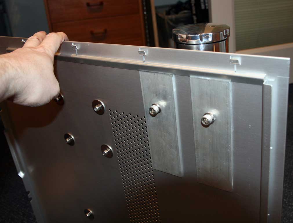

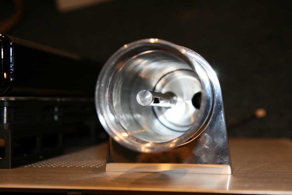

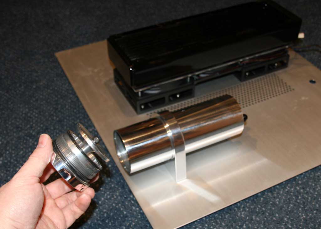

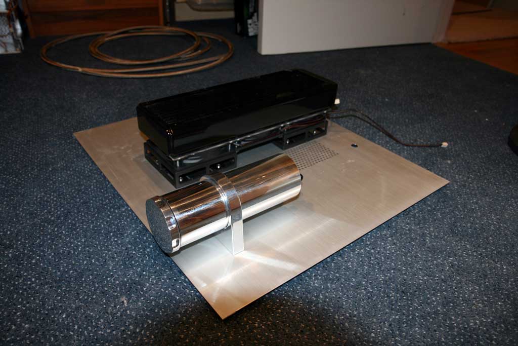

The first billet reservoir I got had 3/8" NPT taps, but NPT doesn't look that great with the tapered fitting sticking half out of the hole, plus I hate teflon tape and all that crap, so I got this Billet Specialties power steering reservoir which uses AN straight O-ring boss taps and also has a nifty slotted tube on the intake to prevent frothing (which if you've ever worked with Laing pumps, you know is a very handy feature).
