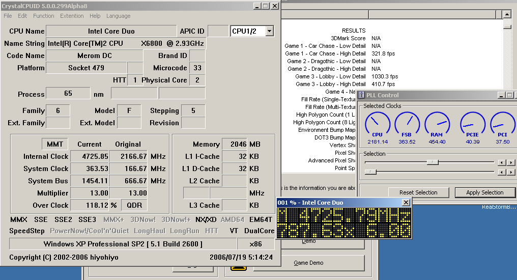

Yes, results are low, but something is working on this "quad system:Quote:
Originally Posted by Micutzu
in 3DM03 Fillrate test I have very big boost SLI off vs quad SLI on on two card setup:
two 7950GX2 cards, SLI enabled- 21877,6Mtextel's
two 7950GX2 cards, SLI disabled- 11445,9Mtextel's -over 90% boost
In same test GT2 max fps was way higher under quad mode.
In Aquamark I have 11FPS boost. 100 vs 111 on quad or whatever mode :D
I've monitored all system power consumption- when Quad SLI is active, power consumption was avg. 50W more.
And netburst intel are weak at such low MHz (3,8GHz), even if they have Extreme logo :)
