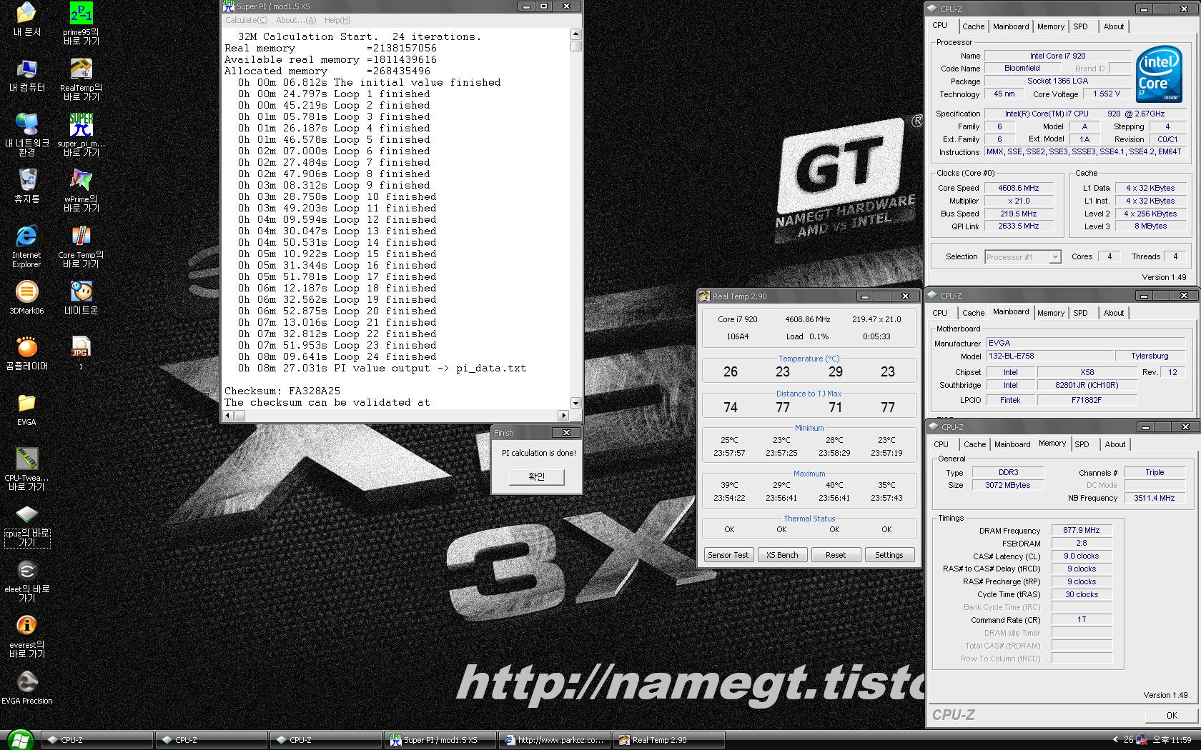

i7 920 @4.6G 32M PI
BCLK 220
Multi: x21
QPI/VTT : 1.4v
Vdim : 1.8v
Vcore : 1.55v
cpu vtt : 350%
cpu pll 1.8v
qpi pll 1.4 v
ioh core 1.25v
ich 1/0 1.45v
ich core 1.2v
http://cfs13.tistory.com/original/20.../49812253b2f5c
http://cfs13.tistory.com/original/36.../49812253ceab4
http://cfs13.tistory.com/original/13.../49812253ebbae
i7 920 [3838B079]
