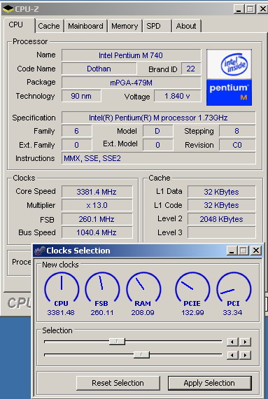

my maxscreen with 740
fsb 533 on CT , not try FSB 100 but soon
under cascade with p4 ihs
http://112233445566.free.fr/PM740/3381%20PM%20740.jpg
Well done skirms! :D
