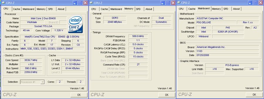

Some quick results:
590FSB
http://i266.photobucket.com/albums/i...san/590FSB.jpg

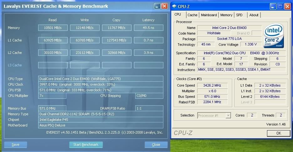

Everest @ 571 FSB
http://i266.photobucket.com/albums/i...571fsbcopy.jpg

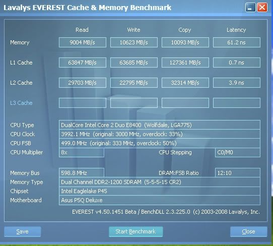

Everest @ DDR1000 4-4-4-4
http://i266.photobucket.com/albums/i...0004-4-4-4.jpg
