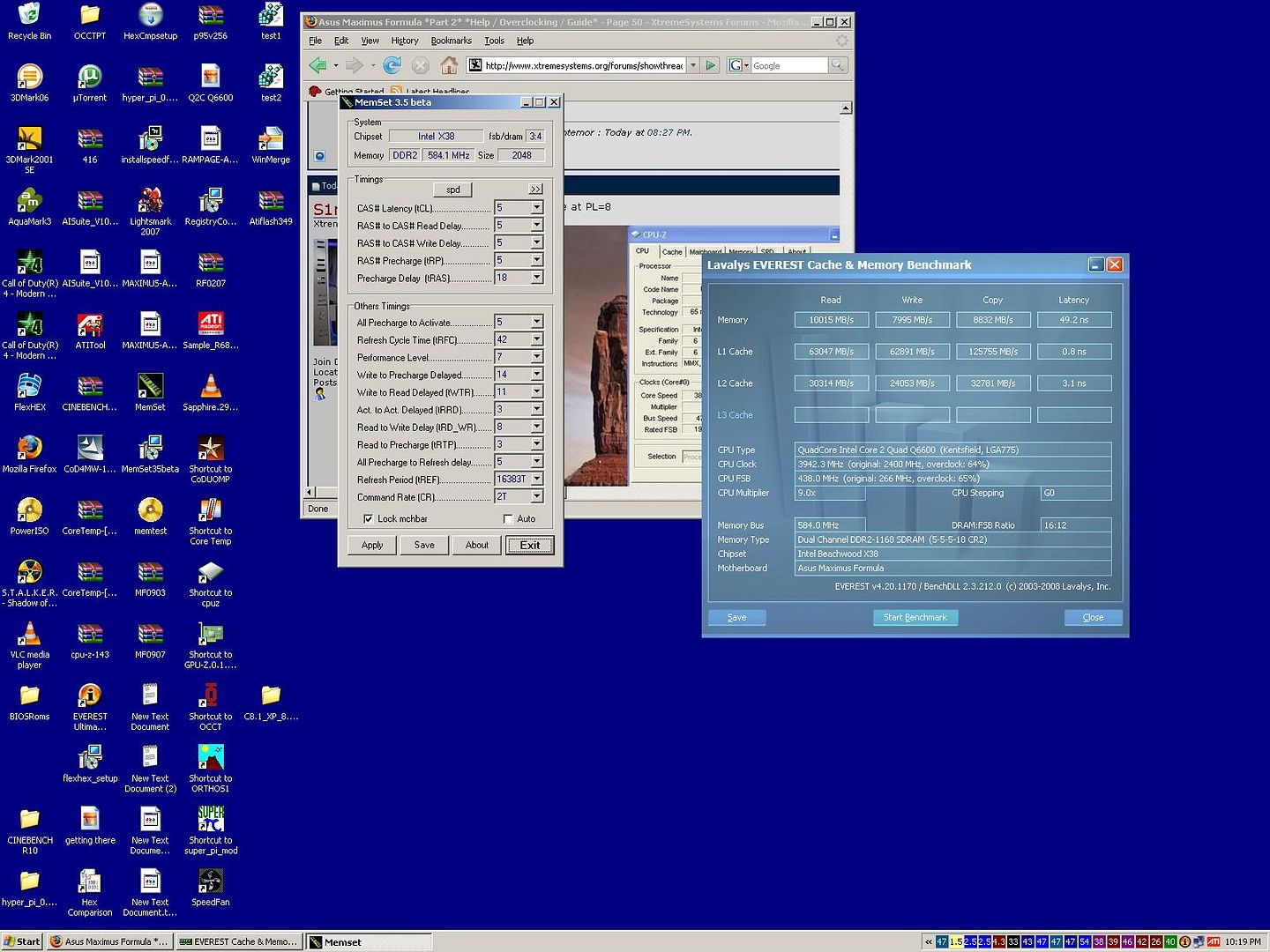

before
http://i48.photobucket.com/albums/f2...n22976/pl7.jpg
after
http://i48.photobucket.com/albums/f2...ageformula.jpg
with the rampage bios can get cas4 stable with common performance level of 6
need to test if i can oc it a bit more on this bios but i sure could tighten down some memory. :D
I could only seem to set the performance level as low as 8, what did you do to get 6 or even 7?
What bios settings?
Common performance level 6

could only do it in cas4 though, cas5 could not get below 7
im at work now so i cant look at the exact settings but the ones above mentioned allowed me to go lower # performance level as i recall.

I can now do PL7 @ 500fsb+, needs about 1.6+ vnb tho.
I'm currently doing 8.5 x 500fsb, Cas 4, PL7 set (All pull-ins disabled).
