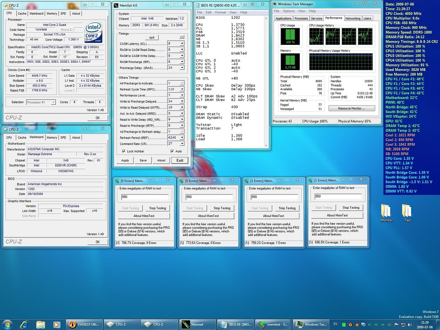

I give up to get my 2x2 Transcend stable @ 1800, I get P95 blend (4x850mb) stable but with the same setup I canīt get passed 500% with HCI Memtest (4x850mb), if I bring down Twister from strong to light and some DRAM skew I come close to 700% but thatīs it.
With LinX I only pass one, error in the second one and I also get some random BSOD just idle at desktop.

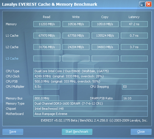

i feeling the numbers are a little low for the clocks i have. is this about right, or is it just me?
http://img.photobucket.com/albums/v2.../cachemem3.png
Looks low mate, but sometimes a different version of Everest is nite and day difference. I prefer to test with Pi 32 to see how efficient my bandwith is
tried another everest version, numbers are even lower. just for confirmation, i can run the 1.65v ddr3 intended for x58 platform on this x48 platform at 1.8v right? i know the board handles it fine, but memory specs only states 1.65v as highest. the older memory version is actually 1.8v, so i think these sticks i'm using are just undervolted for x58 usage right?
Nope the sticks are calculated for 1.65 daily voltage , so beter stick to that.. no matter what platform you run them on.

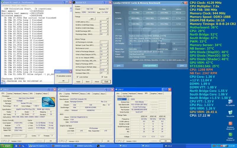

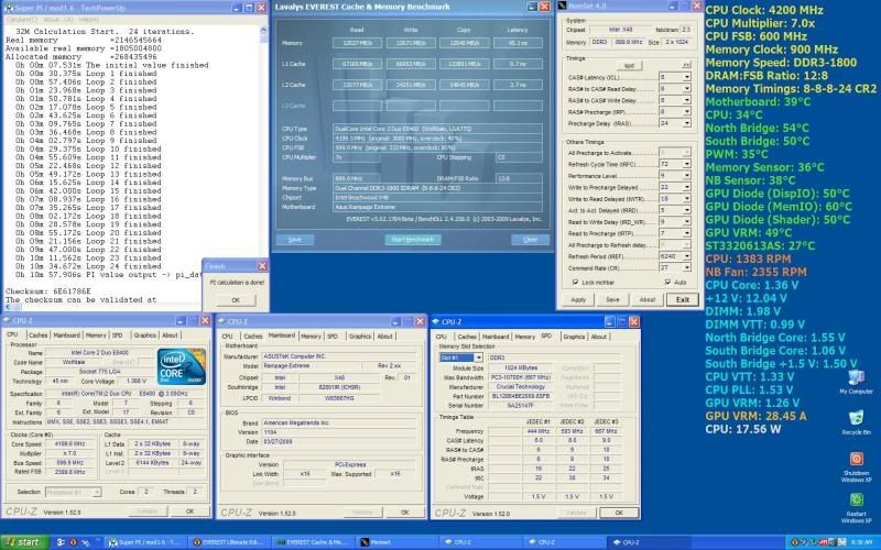

http://i44.photobucket.com/albums/f1...0x700E8400.jpg
http://i44.photobucket.com/albums/f1...Pi1101140s.jpg
