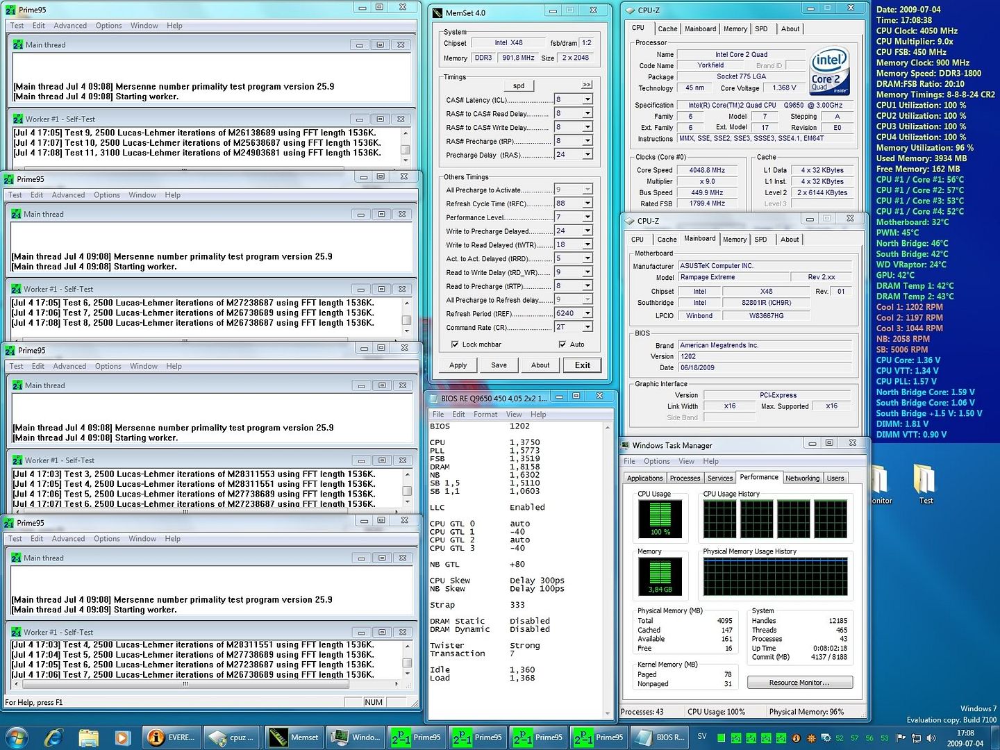

I ran a P95 custom blend (4 instances of 875mb, no affinity set) for 8hrs before a stoped it, good enough for me.
As I mention in a previous post, when I run LinX (max problem size, max memory use) it give me a error right after the first run and I canīt figur it out why and anything above 32mb memory use throw me an error, hmmm.
Hereīs a screenie with P95 custom blend (4 instances of 875mb, no affinity set) @ 450 4,05 2x2Gb 1800 888 24 2T Strong tRD 7.

Nice work there, I tried to get the Kingston HyperX stable yesterday at 2000mhz, It fails on Test 5 on Memtest... but before I couldn't get past 1900mhz, Seems the ref volts are so important to get the hypers going on this board.
Yet I must say that if I run the Hypers at 1668 6-6-6-18 1T (all 500FSB tests) I get better bandwith then with the rams at 2000Mhz C8-8-8-24 1T( unstable) at the same PL
I've read somehwere too if I post at 495 and setfSb in windows to 500FSB that I geteven better bandwith, can anyone confirm that ?

Iīm still struggle to get those Samsung stable, P95 blend, HCI memtest fail with in 100%, LinX fail after first run and sometimes it BSOD on my all of sudden, all with the same setup :(
Then I see you and cheapseats run those Hyper rather easy ~1900C7, that makes me wounder if it worth the struggle with my Transcend, it was easier to get my Dominator 1800C7 to run 4x1 @ 1800C7 then to get those Transcend to run 1800C8.
Those Hyper are getting closer but then this "Elpida Hyper Graveyard" are there lurking :caution:
