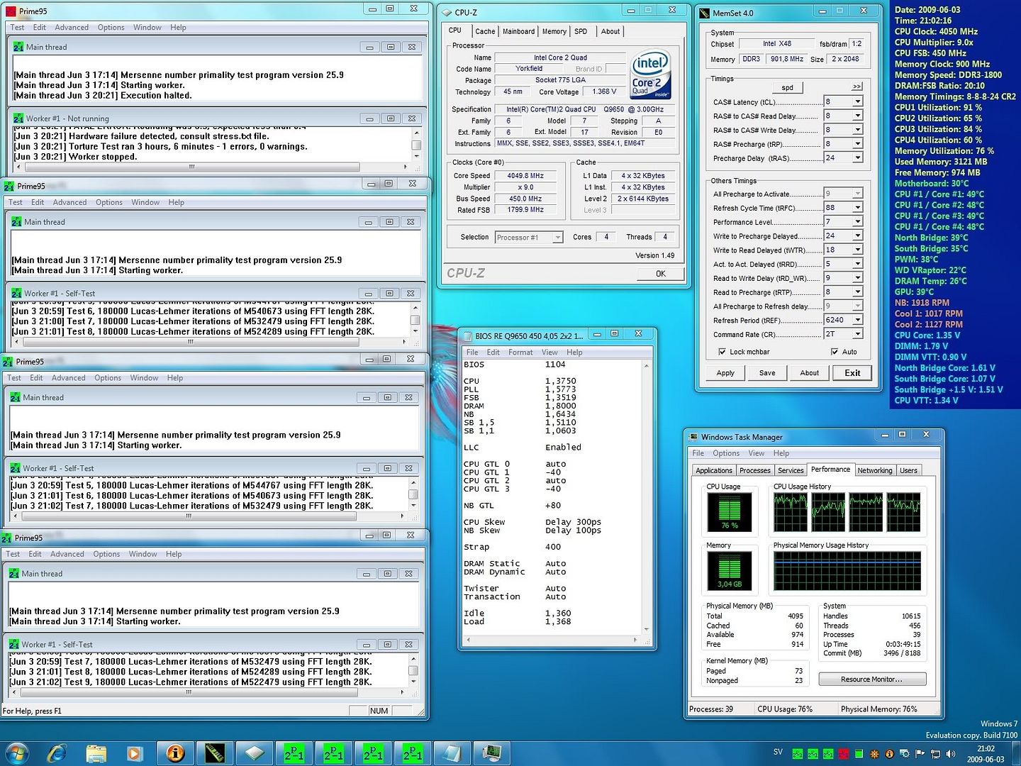

No, Iīm still with my RE, give it a last chance before I switch to the EP45T-UD3P.
Got passed 3hr but at 3hr 6min one core fail )%]^`#"!&% :mad:
Did try LinX but couldnīt get pass 1 run, not good :shakes:
Back to the drawing board and do some thinking.

Unlucky m8. good effort. What a bout a little more VDIMM volts? Mybe 1.85/1.88v??
That is futher than I can get. I cant even get into Vista but I' m runningn lower volts than you.
I will keep trying.

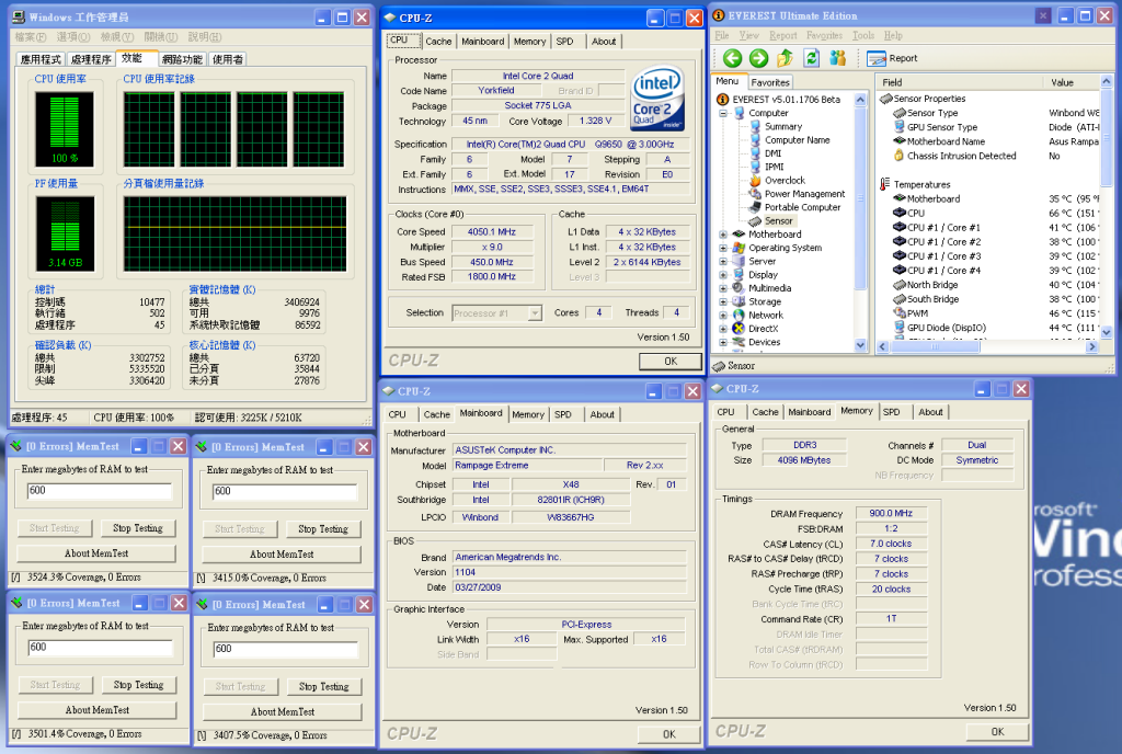

Nevermind got a few free time to have a quick test, just to prove the OC ability of an RE.
10 Loop IBT Test, 450 FSB, 4050Mhz 1.325v vCore, tRD 6, CL7-7-7-20 1800Mhz 1:2 divider @1.59v BIOS

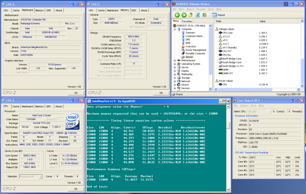

Overnight memtest passed
http://i317.photobucket.com/albums/m...rstan/RE/4.png
Just rub it in :mad:, just joking :D
