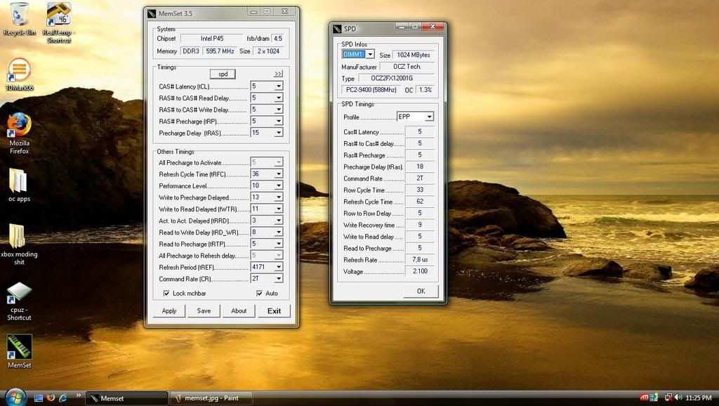

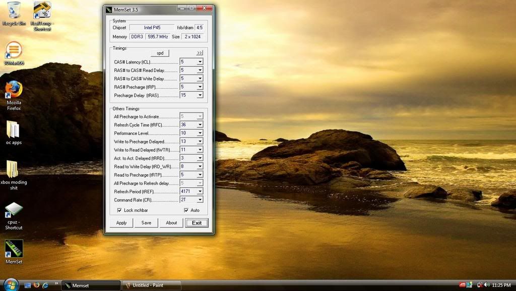

dang thanks for the info bro now im never going to buy a ocz powersupply lol but anyways what do you guys think about this?
i have ocz ddr2 1200 ram flexII and when i open up memset i get this (notice the memory info at the top)

and when i click on the spd it gives me the correct info on my ram

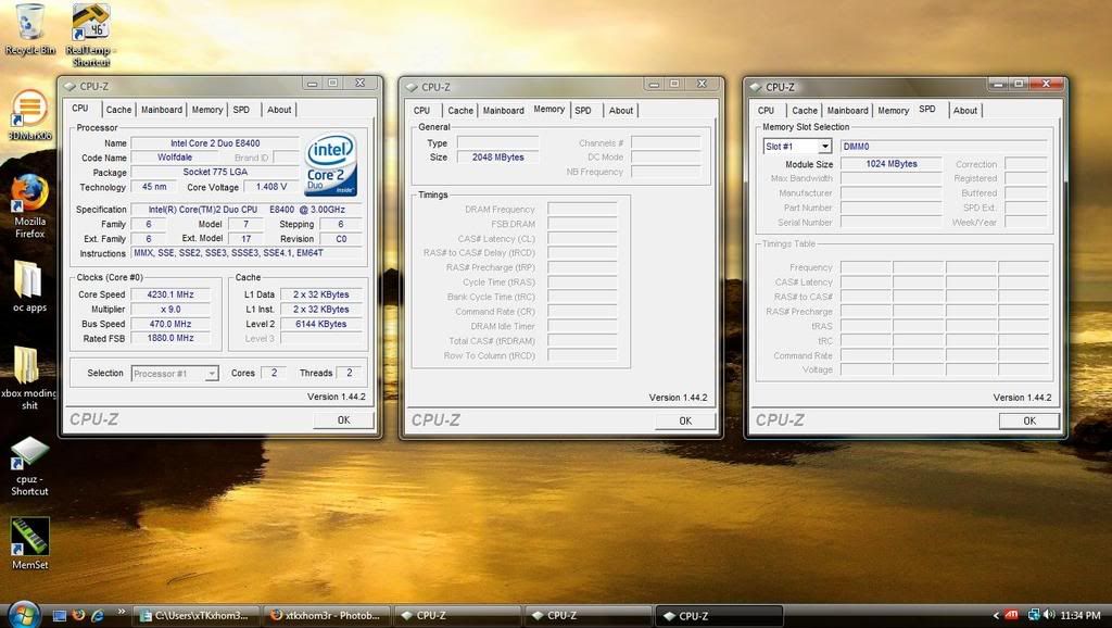

but on cpu-z it doesnt give me anything

what could be the problem? is my memory taking a :banana::banana::banana::banana: or is it just not compatible with my board?

ah ic i updated cpu-z and it shows the info now thanks! the memset i have is the most recent though dont know why it would show that weird stuff but oh well....anyone have the same memory i do? any stability issues? i seem to have alot with this memory
