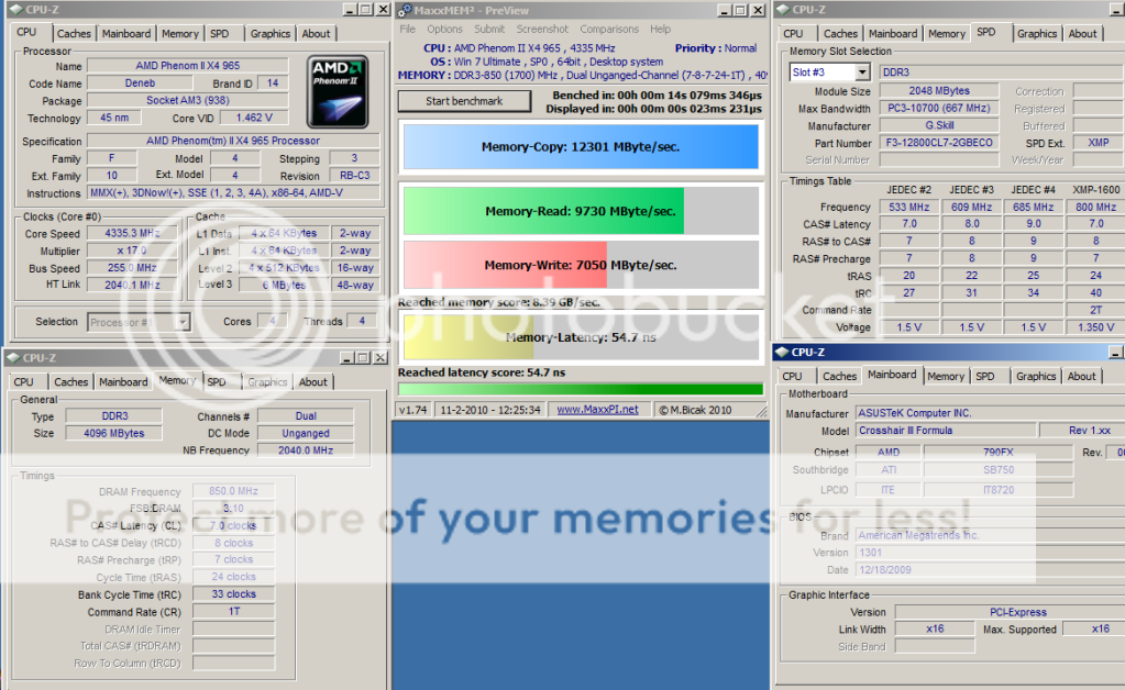

After benching all night long with MSI I'm now at my work with my Giga and sticks are ultimate crap for AMD, I will give up on them, go home to sleep and switch to Intel after, now I hope sticks can't run advertised timings so I can return them with good excuse :) At least now I know why they are 40% cheaper than my Dominator's :)
I was thinking that tRCD will give me trouble but CL is killing me...
1333 -> cl7 1.65V, up to 1.90V nothing helps
1600 -> cl8 1.65V, up to 1.90V nothing helps
1666 -> final boot whatever timings, dividers and voltage used
So, this are tightest timings with 1.65V, up to 1.90V and different dividers nothing helps
