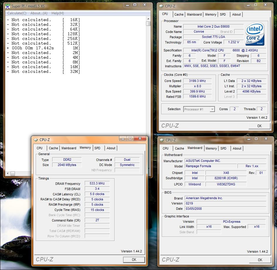

Well, I just finished installing this RF. It came with bios version 0219 installed.
What would be considered normal for the north bridge temperature, bios shows 57 celsius and infrared meter gives a reading around 60 celsius from the pin fin :rolleyes: heatsink on the middle?
This is pretty soon after starting to play with the board. (trying to boot linux live CD and changing the settings as kernel panics..)
The motherboard is inside the case and the parts are in my sig, no side panel on the case though.

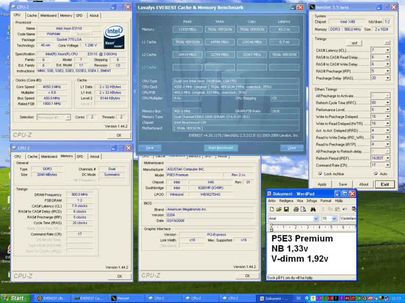

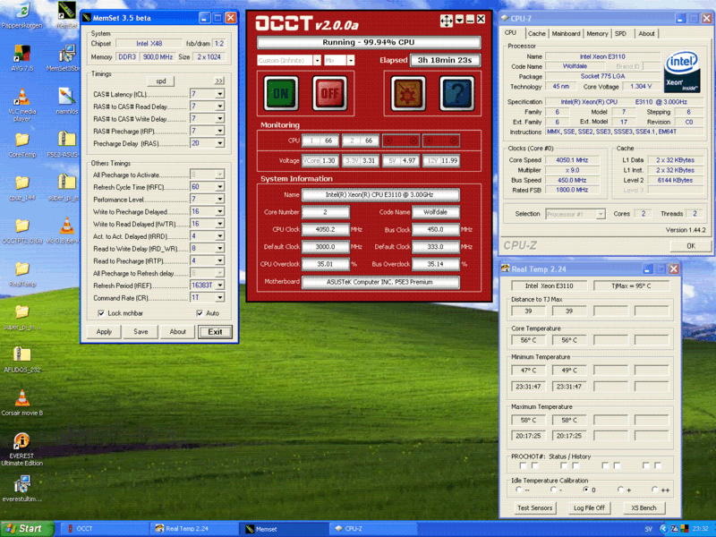

I have been running this baord with my Xeon 3110 for some time know and i like it very much!
Infa: Is 333 strap faster with lower FSB for you? Say Sub 470mhz? I always use 266 strap
ASUS P5E3 Premium 0204 Bios
NB @ 1,31v
Mem @ 1,98v
266 Strap
OCCT memory test, STT ProdjectX needs 2,04v on S2E ;)
http://i30.photobucket.com/albums/c3...primetight.gif
Latency @ 7-6-5-X So close to 12k...
http://i30.photobucket.com/albums/c3...7-6-5-201T.gif
