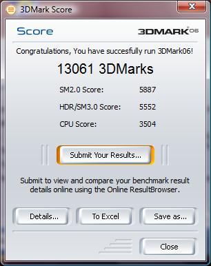

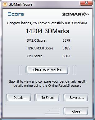

Last issue, my video card is running slow. 3dmark06 is running at 30FPS instead of 90FPS in the first test. I am about to re-install the drivers and see what happens. Is there a setting in bios that I have disabled that affects GPU performance?
Update: flashed bios to 0603 and now have GPU at normal level of performance. It might be a driver conflict with older BIOS or a hardware issue because the new 8800GT support PCIE2.0. I do not know, but am glad that it is working now.
Time to overclock
Well, here is the problem. My GPU starts running slow when I overclock past 3200MHz. At 3600 my 8800GT is running at 30FPS. At 3200 my GPU is running at 80FPS.
The only changes that I have made between the two CPU clocks are FSB and Vcore, so somehow one of these settings is slowing GPU performance.
Anyone seen this before? Any solutions?
