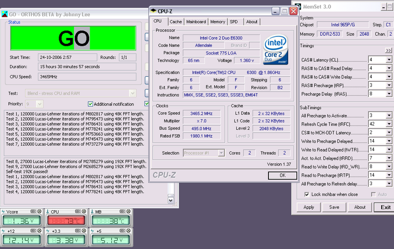

I'm very satisfy with these babies: P5B Deluxe Wifi AP Bios 0801 + Teamgroup Extreem 2GB Kit + Allendale 6300 :up:
Right now, I toasted them to look the stability for my daily used.
http://i135.photobucket.com/albums/q..._98/FSB495.png
73'C doesn't feel very safe to me. stock cooling?Quote:
Originally Posted by Sadhana
