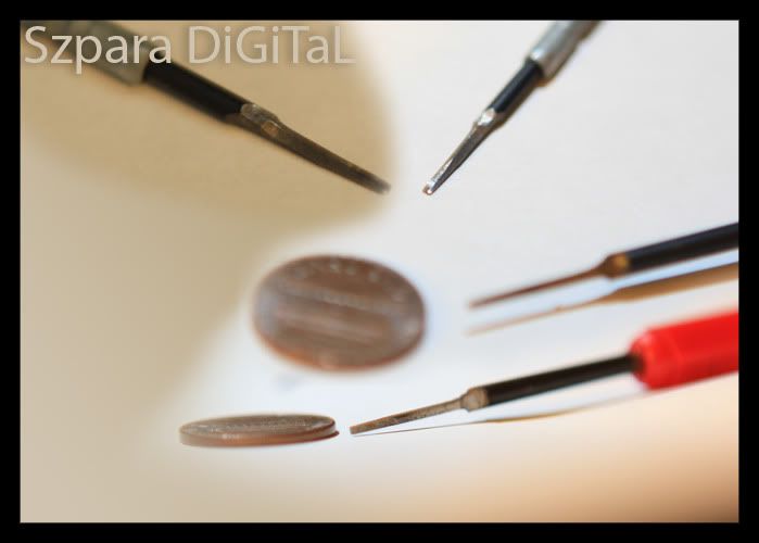

i wish a have read your theat sooner, but any way:
sance im nearly all the time on tight bugget i tend to make my own tools and recyle all connectors cabes and bits of peases of any kind, and so you may ask where do i go with this?! well lets get to the point; i have taken a small screwdriver and grind it down with a bench grinder of corse. results are just "Ahh, Its just what I needed!".
