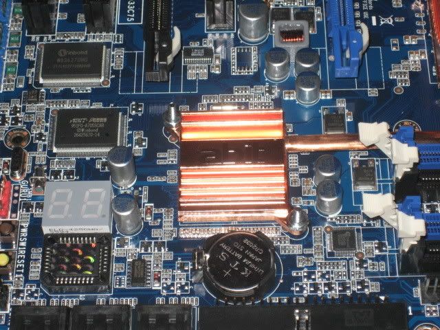

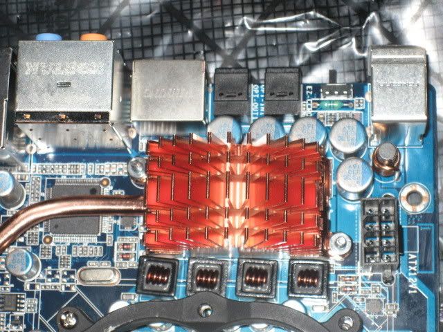

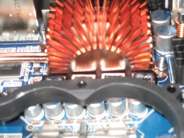

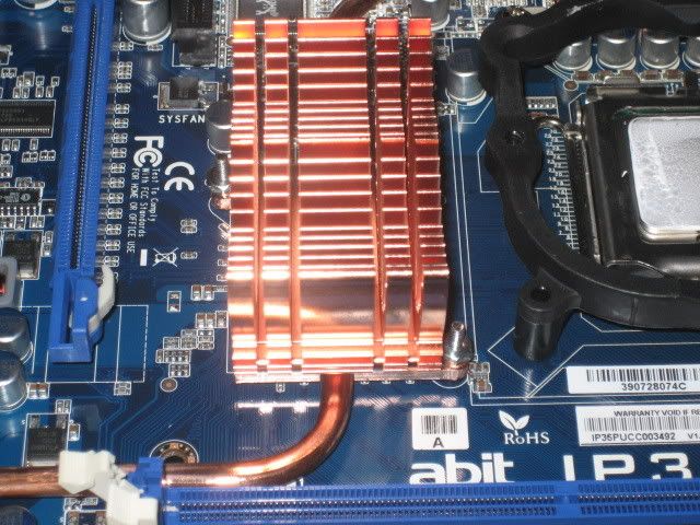

Thanks. I'm doing your heatpipe mod as I post this :D Homedepot only had the #4 Galvanized washer. And the #4 bolts are flat head bolts but it'll do. I'm gonna leave the thermal tape on until I receive my MX-2. BTW, do you guys think it's worth the upgrade from a Zalman 9500 to a TRUE?
cool!:up:
Heatpipe Mod done! I think that 1/2inch would have done it. The 3/4 inch is simply too much. Although I think it would have been harder to install a 1/2inch so I'm happy :p: Here's some pix. Enjoi :D
http://i11.photobucket.com/albums/a1...rum/Ali008.jpg
http://i11.photobucket.com/albums/a1...rum/Ali007.jpg
http://i11.photobucket.com/albums/a1...rum/Ali006.jpg
http://i11.photobucket.com/albums/a1...rum/Ali005.jpg

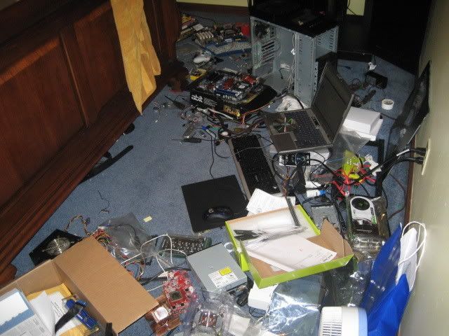

Finally my work area (bed room)
http://i11.photobucket.com/albums/a1...rum/Ali009.jpg
That mod is much easier if you bring the bolts down from the top and then use some dikes to cut the extra bolt length flush with the nut... Either way it works quite well.

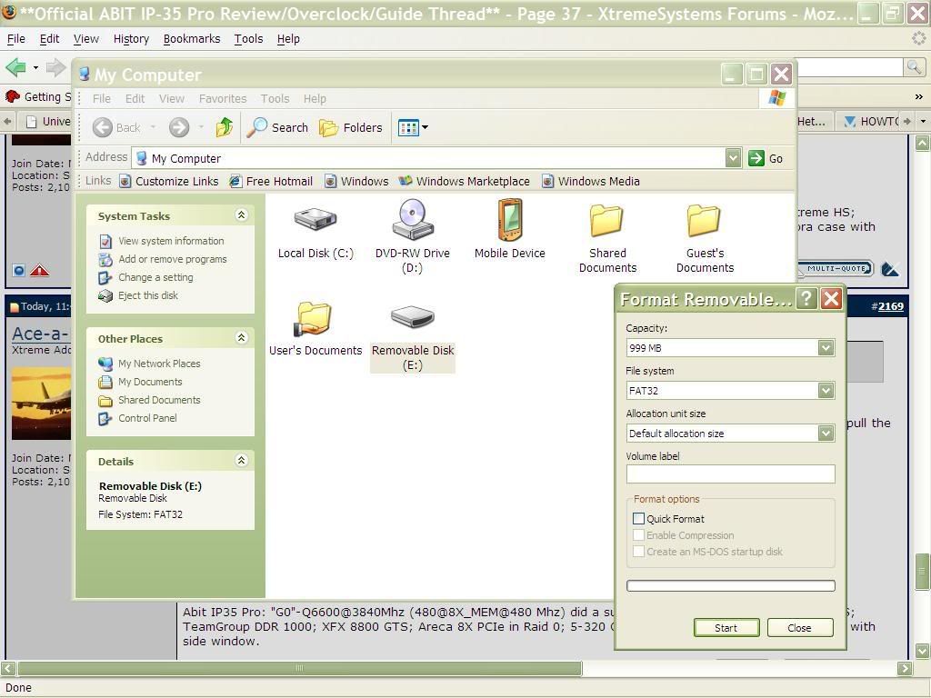

Anyone know what settings I should set in bios to boot from the flash drive? It's not as simple as my old p4 system :(
Great minds work a like :D BTW, I installed that hp program. I just don't know where to find my Dos files. Any idea? it says it needs them from my pc. I've done this before but it really has been a while :rolleyes: I took the win 98 files in the link instead. But the motherboard is either having a hard time booting from the usb drive, or the files aren't working.
Well you can't use windows format tool to make an ms dos usb boot drive. But I figured it out. The link you gave me had two links. One for win98 dos files and the other was the hp tool. You were supposed to use the win98 dos files as the source. Bah I guess I'm tired. But no sleep, not yet anywayz :D
hp tool FTW.
I just flashed it, but I'm not all happy yet. It went through the steps and started flashing it and I started praying :D It said flash complete and I hit F1. Now the monitor went off but the motherboard didn't reset. And because you said this will take 2 minutes when it took 20 seconds, I'm scared to reset it :eek:
EDIT: Ok, I grew some balls in the last 30 seconds and decided to reset and it failed :( it's not working any more. I don't know whether to RMA or what. Just kidding it worked :D
LOL...you prankster!...hehehehehehehehe:D
I don't understand. It doesn't let me choose the ms dos start up. I don't have a floppy drive, hence why I've been talking about usb the whole time :p:
