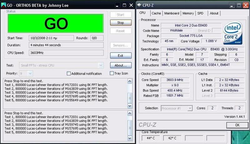

just playing today to see...
Asus doent put lower than 1.1 volts...
http://i96.photobucket.com/albums/l1...untitled-9.jpg
you're lucky on my abit ip35-e lowest is 1.225v bios.
