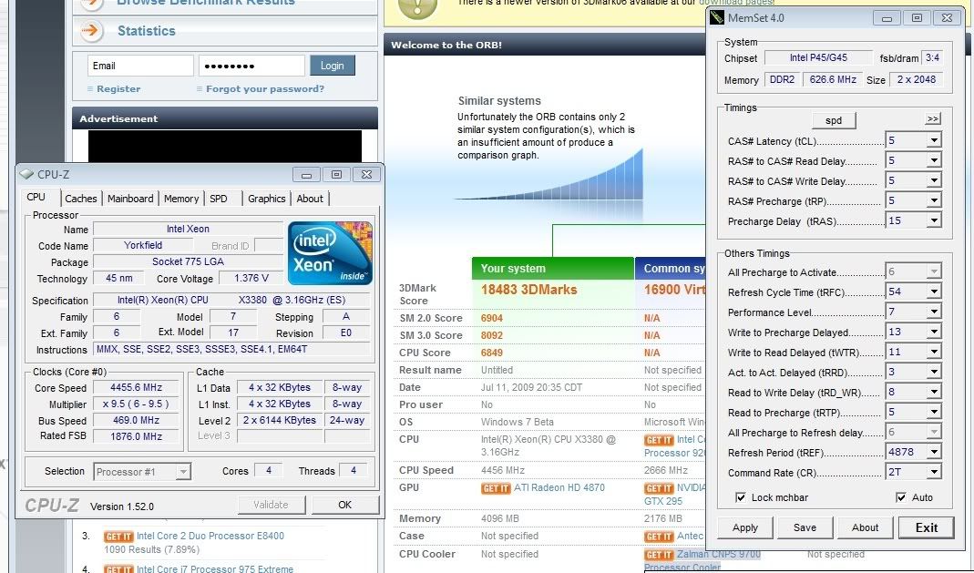

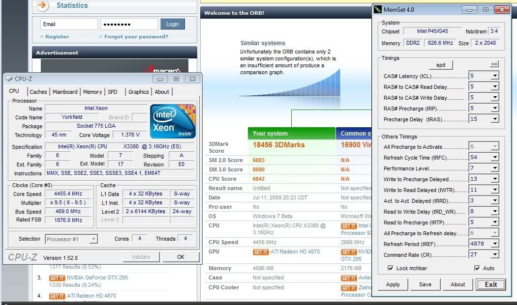

Yes I was using 200d. I couldn't get stable at 1200mhz. Trying the OCZ Platinum 1.8v now, working on 1200 now to see if it brings the score up.
Was able to get my mem to run 1200mhz but using the 250a-4:5, not 240b-5:6 divider. That limits my oc to 4.32ghz. Ran 06 again today in Windows 7 using my HIS cards.
http://img528.imageshack.us/img528/8...0mem432ghz.jpg
