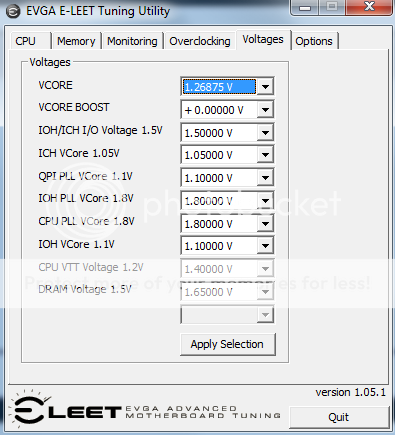

I hate to give up so early, but I can't get past 144 BCLK on stock voltages, and after perusing this thread I am at a loss for what voltages to tweak... :(
e760 gskill trident 2000mhz cl9. Mem div at 2:10 so it's only at 720... err, 1440... using the xmp profile. turbo mode off. HT on.
for anyone who knows what they're doing and forgot what stock voltages are, :p:
http://i767.photobucket.com/albums/x...p/Untitled.png
And mem (no bios template right now sorry. I know I need that):
http://i767.photobucket.com/albums/x...Untitled-1.png
So yeah, haven't been able to put any effort into this for almost a year; I try to keep up on this thread but I didn't bookmark the relevant posts. Thanks for reading.
