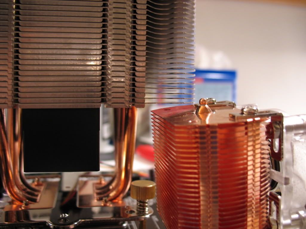

Oh you know, the usual...first run, stock settings, 5 minutes of Orthos and no mouse move. Then the uh-oh smell and I shut everything down. So far it looks like the only casualties are mobo (replaced) and RAM (working on it). The NB was incredibly hot tho. The new one has been replaced w/ a Jing Ting and it gets warm. :D About 1/8 inch clearance, hehe.Quote:
