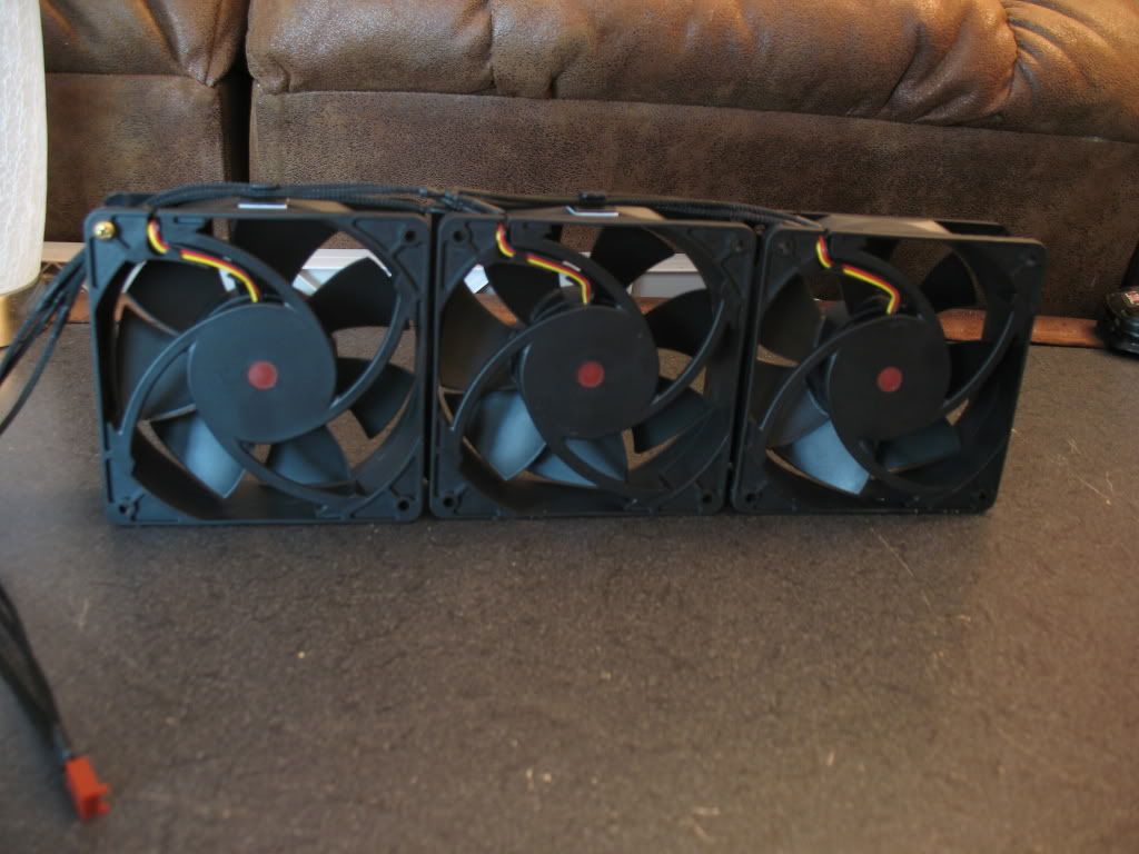

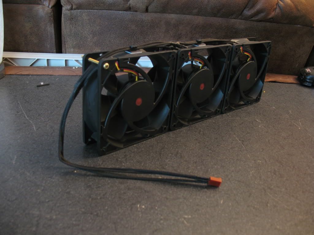

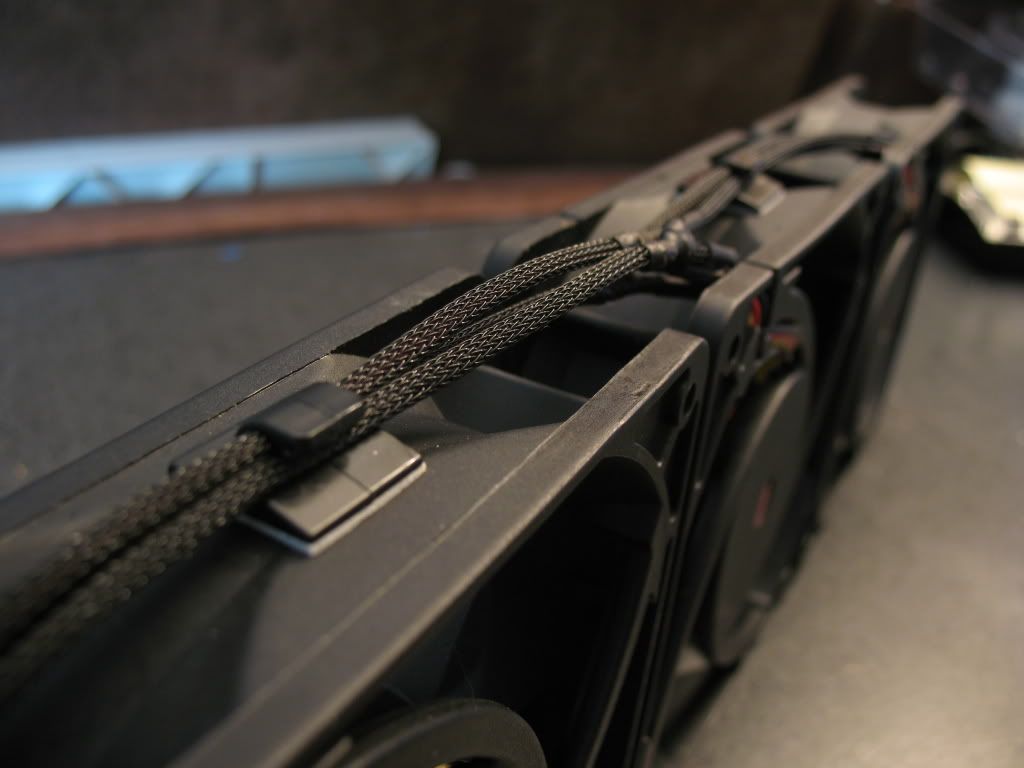

Soldered the second set of three fans together, one more to go!
http://i188.photobucket.com/albums/z...1/IMG_3414.jpg
http://i188.photobucket.com/albums/z...1/IMG_3416.jpg
http://i188.photobucket.com/albums/z...1/IMG_3415.jpg
Nice soldering and sleeving, planning to hook them to a single fan controller?
