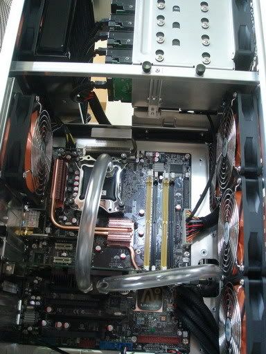

Will you be able to remove the ram without removing the hard drives ?

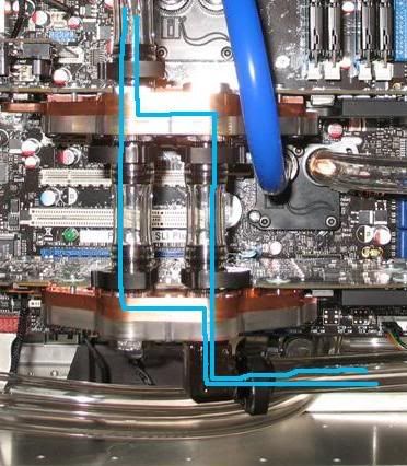

That is a total pass through. A guy at the last Intel LAN I went to had a boutique rig (not sure which one but a skull is their logo) in which they had a dual card DD loop in which the flow went down from card one to card two by passing card one as in this loop but instead of exiting the second card like this loop it returned the flow back up to the first card via the other barb and then exited the card loop via the right top barb . . .it would operate at stock but if you oc'd it even a hair all hell would break loose . . .

Go out to EK and see how the cards flow, and you will quickly see why this works. Frankly after I thought about it, I was amazed that more people didn't do this. However it's always easy to see something after you understand it, just like you always find things in the last place you look :)
Except it IS forced to pass through both cards. The resistance in each water block is identical (or as close to identical as the manufacturing process allows), and the water is going to be forced to split between both blocks. Just take a couple of minutes to think about how the internals of the blocks are laid out. If he only had one of the tubes connecting the card, then yes, you're right, it wouldn't work, but with both connections there, it WILL work just like a Y-splitter, except the flow would be more even than you'd be able to get using a Y-Splitter.

I suppose it would probably work. The major benefit (to me anyhow) of 2 separate loops is to keep the gfx cards from heating up my proc/mobo. The cards generally run 15-20 degrees C hotter than the other parts ...
However the water temp doesn't change a whole lot through the loop, on the order of a few degrees at most, so I'm guessing 'virtual' loops might yield similar benefits even if they shared a reservoir.
Some more nice things about 2 loops: you can run different color coolant in each loop if you want, and you could potentially have them run the fans at different speeds, ending up with a quieter machine. Also, you will get better flow with separate loops. Just a few thoughts.

in all tests shown gpu1 or 2 is seriously a lot higher.
The cores are no where near evened out.
Ive tried it as well, and i personally like my gpu's to be within 1-3C of each other when i sli or xfire.
That looping is another example of bling over performance. Sad to say. :\
Simular to how people throw in random 90's cuz they look cool.
The simplist option would be to paralell the cards if your that anal about tubing layout, and it would solve your uneven core issue.
oh one more thing, the best way to test it is to load up your GPU's and watch GPU 1 or 2 SKY rocket, while the other stays almost FLAT.
That is the result i and many others got while twiddling with this setup.
Was a great waste of 4 hours. :P

a) I really don't understand your post
b) If you're talking about dual loops vs. single loops then it still doesn't make sense
c) When my machine is pulling 500 watts from the wall, with both GPUs going flat-out for many many hours, both cards are still within 1 degree
d) This IS a parallel layout
Forgive me if I misunderstood, but it's not clear what you're talking about.

okey im sorry. Lemme see if i can simplify myself.
I am only talking about your gpu loop.
You said you had the first card setup as inlet outlet, and connected to the second card.
Basically the water is going in a U. The first card will heat up while the second card will stay still.
You said it was okey to config it like this. I am saying its not, because you'll have a very big delta between card 1 and card 2.
DB also warned you about this type of config, and you still said it was okey.
I am mearly double verifying what DB said. I have tried that config, and as i said card 1 and card 2 has too much of a temperature delta.
2. Can you show a pic of this. Cuz i never could get 1C within the cards. AS i said I noticed it being more then 10-15C varianace.
A program like ATI Tool or RTHDRIBL is great to load up your gpus
3. No a true paralell would have = flow to both cards. So inlet would be on both card 1 and 2 using a Y and exit via card 1 and 2 on outlet via Y.
Once again here is DB saying IT WONT WORK.
And i am saying ive tested this, and IT DOESNT WORK.
If you have pictures of it working. I would definitely like to see them. Im not calling shins, if you have a working setup, i would like to see how you pulled it off.
The closest i got to it was using a 3/8th id tubing instead of 1/2id tubing for the bridge on gpu1 and gpu2.
Adding restriction to the bottom cards will allow more water to flow to the top card. This might work, but i still wasnt happy with the temp deltas.
My last attempt although very painful, was to use some form of reducers to mirror the flow. Another failed attempted. :X
Sunay please dont get me wrong, i am really curious on how you pulled it off. I would love to tube like that, but my OCD wont allow my gpu's to be like that unless i can = the temps.
