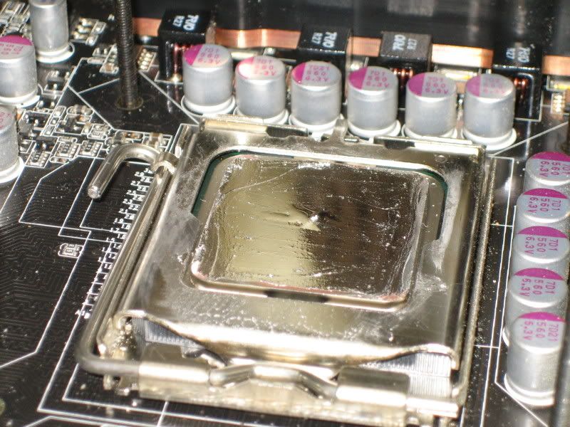

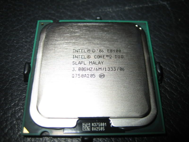

A bit of an upgrade this weekend for my machine...
http://i80.photobucket.com/albums/j1...0/E8400007.jpg

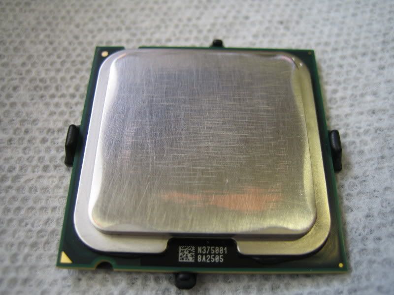

The IHS is not nearly as wonky as my E6600 was, but still has high spots in the wrong places

Now that it is flat, a glob of my favorite TIM...

Oh and nice lapping. But why does the IHS looks copper red in 3rd pic? Is it just reflection from something else or did you prep it further after lapping?
All in all seems your weekend has been very productive :clap:
THanks! The red is the final lapping, the first picture was just to show the high spots on the IHS. The TIM is Coolaboratory Liquid Metal...excellent stuff, I cant say enough good things about it.
