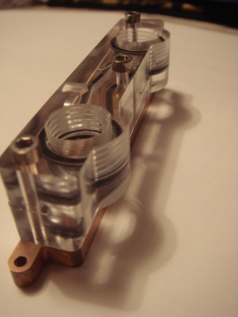

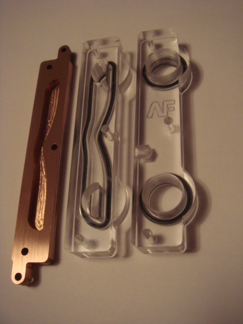

look guys what i am getting for my dq6 :)
http://www.hardware.feichti.com/gfx/v2000wakue/af/0.JPG
http://www.hardware.feichti.com/gfx/v2000wakue/af/1.JPG
i get also NB and SB coolers :)
Feichti
nice Feichti, where you find those? are they expensive?
