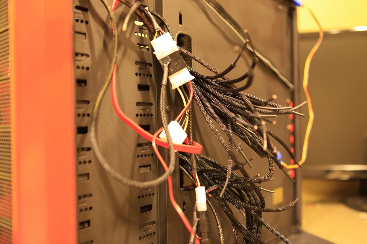

I'm having a problem. I'm trying to build a system that needs something sturdier then the regular heat shrink tubes or boots to prevent my split cabels or pigtails from tearing the cable they come out of. I've seen this 'cable thing' on many prof audio breakaway cables, that would be perfect. To show you what I'm talking about, I provided a picture. The thing I need is the yellow plastic thing on the cable below.
Does anybody know what it is called, because I looked for it everywhere on the internet without succes. Has anybody used it or does one of you know where I can order them? I really would appreciate if anyone could help me.
