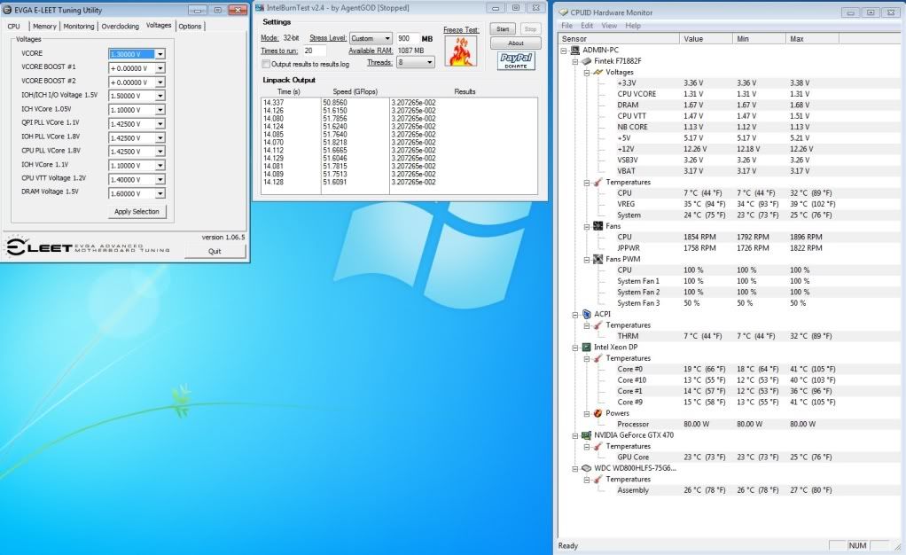

+350 was the full auto setting, with XMP profile for the Corsair GT's.
I manually set it to lower, managed to lower to +225 @ 4.14GHz, or +200 @ 4.00, anything lower would mean 0x07F random BSOD's under full load. I had to boost the QPI PLL a bit too... Running blck of 142 with 1:14 ram ratio.

That VTT i got from underclocking CPU, then setting XMP profile on RAM to run it at its rated 2GHz, and reducing VTT down to the point i was getting BSOD's on LinX and such. Wont get stable under +200... Unless you have another solution for me in which case i'm interested.
XMP is recommended by Corsair in order to run their ram at rated speeds.. any other profile will result in no post or quick crashes. I know VTT can be dangerous that's why i was asking here, maybe someone else with the same ram could tell what their settings end up to be with those Corsair modules.
I tried lowering it but even +200 will lead to crashes eventually.

You sometimes can decrease vcore finding the right vtt-vdimm balance. Then it might help upping the pwm frequencies to a value that works best, as vrms dump some heat into the loop as well. Set the PLL voltages (IOH and CPU) to 1.35V-1.5V. IOH voltage also has to be upped some for SLI and high (base)clocks. 1.2V is a good starting point, but do not increase it, when you don't need it. Minimizing voltages ain't an easy task, but it may pay off in the long run.
So far i've left the default 1.65V Vdimm.. it runs stable at current step (4.14) so it's fully ready for the WCG marathon week that begins tonight :D (Go xtremesystems !) I dont want to risk any unstability before it's over.
Any clue why the default CPU and IOH PLL are at 1.8V ? I'm still feeling uncomfortable decreasing them so much... Even 1.5V is a huge decrease from 1.8V...
I have IOH at 1.2V and ICH at 1.1V (as recommended for USB issues), i dont feel the need to touch them as even at full blast on graphics (furmark, crysis) it's completely stable. Only other voltage i pumped was QPI PLL it helped go over the 4GHz barrier.
Yeah, I also thought like that about decreasing them this much. But it just works great. I was priming full throttle for several hours with cpu pll @1.5V. IOH pll has also positiv or no negative effects on stability in my eyes.
