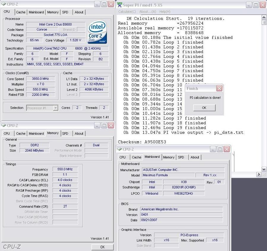

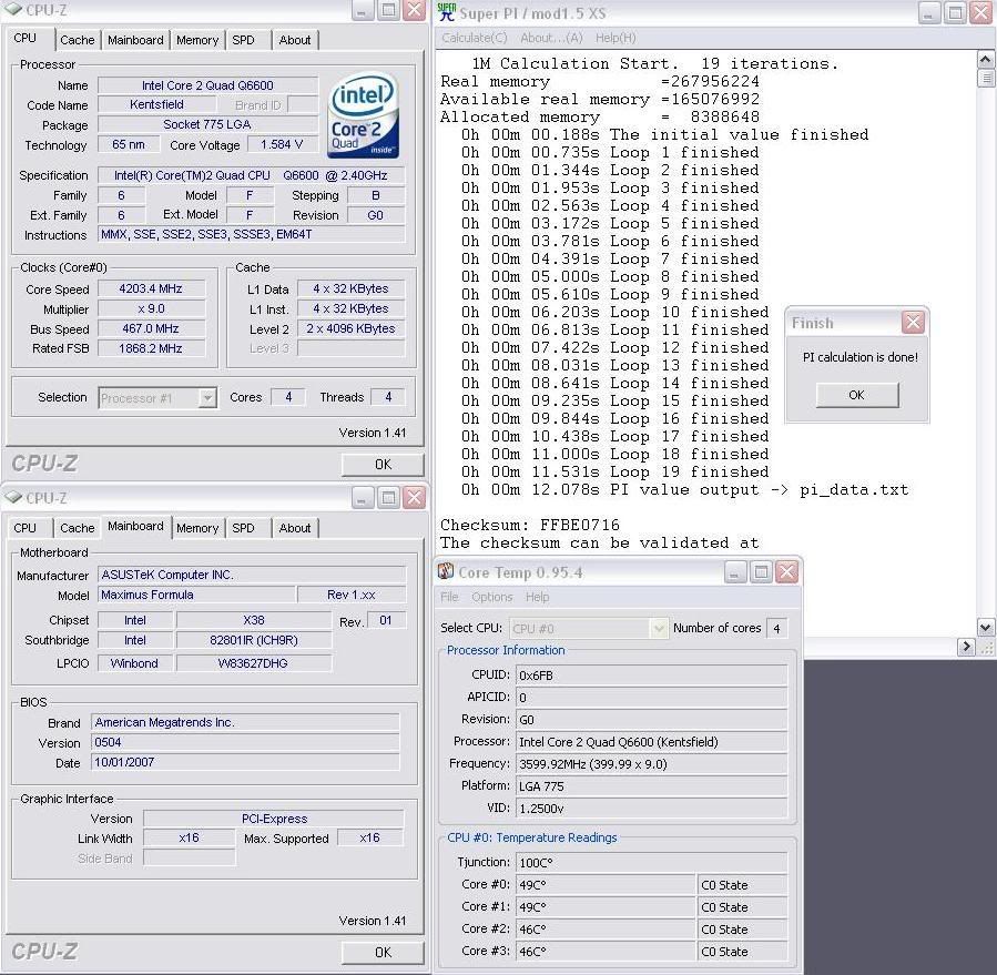

I stand corrected because I have not seen anyone achieve over 470 fsb on this board and was very pleasantly surprised and impressed to see that high of an FSB.
Now the details :
Exact temp on the CPU
Cooling for the NB? Temp of the NB.
Anyone else out here getting anything close to these results with a dual or quad on SS, water or air?
Interesting my max FSB on air chipset cooling is lower than on my blackpearl considerably ;)
You must have a nice Q6600 to hit 467x9 on air...and its not an ES either so im very jealous...
If you like I can setup my board on air tomorrow and provide a breakdown of settings, as far as I can recall voltages were not excessive for me for the air cooling..

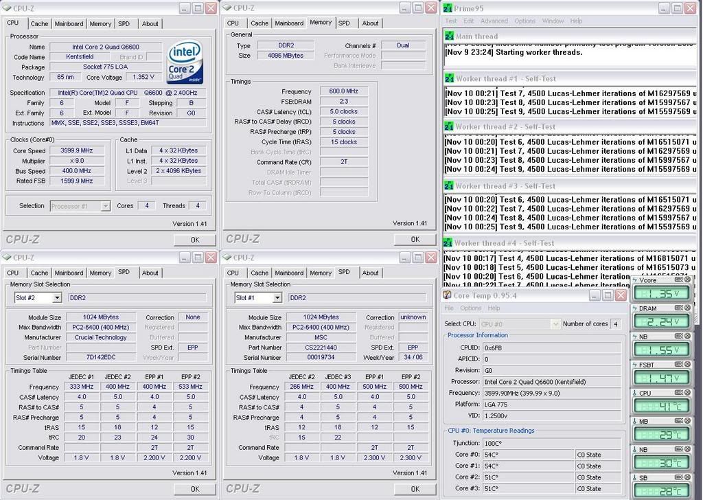

This bloody board still isn't stable. I've just had a random reboot (had to be hardware related as nothing was running) after several days and OCCT/Prime runs showed it to be stable.
I'm just fed up of this board now. Unless some miracle bios comes out soon, I'm going to sell up and got for a QuadGT instead. Save myself £50 and get a decent board.
Kup this is an awesome board...im using 0701 bios and am rock stable at 4150 cpu and 1104 ram....
yes im on phase but the board is awesome it just takes some tweaking :)
Please give me a few pointers, I'm completely stumped. What settings are you running for those speeds? ( I know I can't do those CPU clocks, but I can to get a good FSB)
I like the board, and it's VERY fast, but right now, I'm able to get higher FSB and CPU clocks out of my aging Striker Extreme...and after blowing £200 on this new board, that upsets me! :D
EDIT: I've been on 0701 since it came out, just not updated sig...
sorry, did you want max quad fsb on air? If it's Prime then around 450, for benching around 475-480 tops, depending on the benchmark in question.
