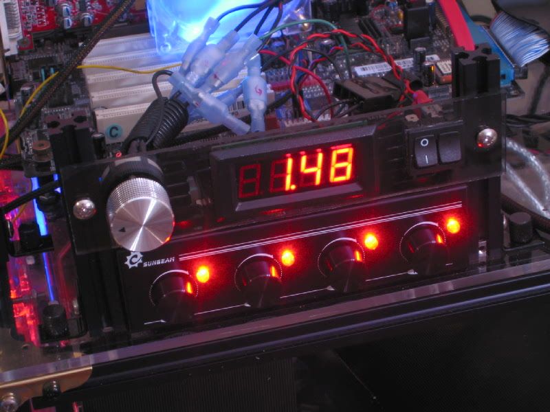

Haven't gone all out on vmods and measure points on this board, yet, for this simple reason--all the way up to 9*370, I've been essentially running the lowest settable voltages--vcore minimal (1.2375V), vmch (1.52V), Vdimm (2.2V). I think when I hit up middle range voltages, I'll start installing measure points. My gut instinct tells me something else is holding me back, I have trouble believing in such as enormously vertical wall that suddenly requires 10 notches up on the core and mch just to achieve 5mhz on the fsb. Then again, I could be wrong. I do have a little secret weapon. 12 channel panel voltmeter!

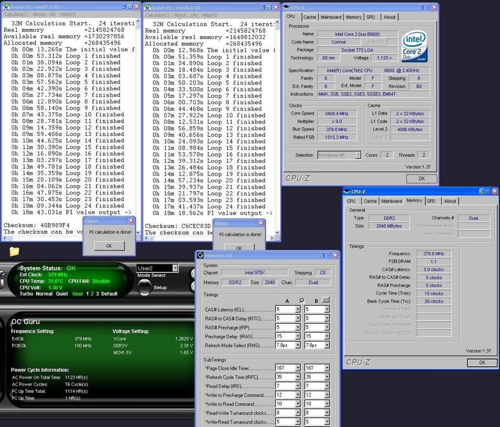

9x379 sp32m stable.

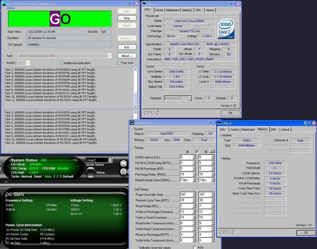

orthos blend 30min stable.
Settings: 9*375 memory 1:1 5-5-5-15-35. Vcore 1.2625v, vmch 1.65V, Vdimm 2.35v.
I know, hardly the most strenuous of testing, but a huge improvement from just earlier today. No dual sp 32m, and orthos inevitably fail within 30s.
